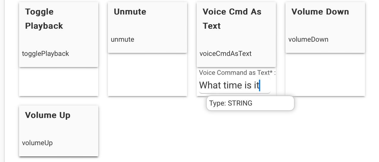

The “Voice Cmd As Text” can be used to send a command to an Echo device, and it will be interpreted as if it was spoken to directly. No need for another speaker to speak to it. Here is an example that resulted in my Echo Show 8 telling me the time:
These commands can be used in Rule Machine.
Oops...you're right. My bad.
