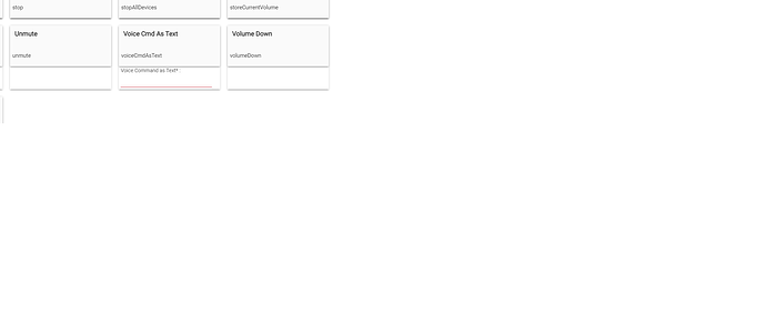

I'm sending command via VoiceCmdAsText
Is there a way to ger Alexa "text" response, as you see on Alexa app
If you are wanting to send the voice command through Echo speaks and then get the Alexa response at the device that you would have gotten if you had spoken the command yourself, I am not sure if that will work or not to be honest. My suggestion would be to try it and see.

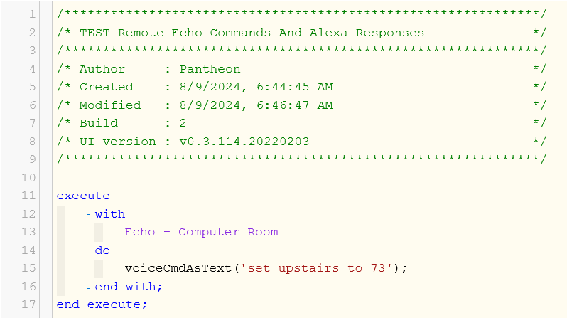

I'm not sure if this is what you are asking, but I did test this piston.
The Echo in my computer room responded with "The AC is set to 73." My upstairs HVAC controller is named "Upstairs."

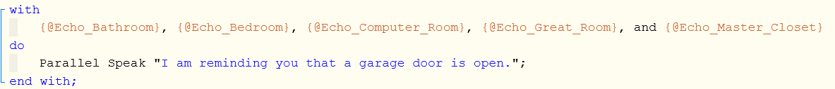

I use the Parallel Speak command often. But I have to type in the response. Not sure that is what you want.

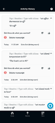

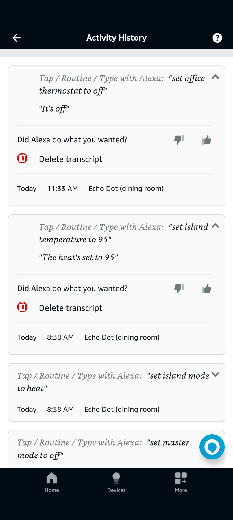

I need the "it is off" or "the heat is set to 95" responses from alexa

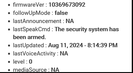

I asked Alexa to set the upstairs temp to 72. She responds with "The AC is set to 72." I was hoping lastSpeakCmd would have that response. But not so...
At this time, I do not see any way to capture the Alexa responses.
