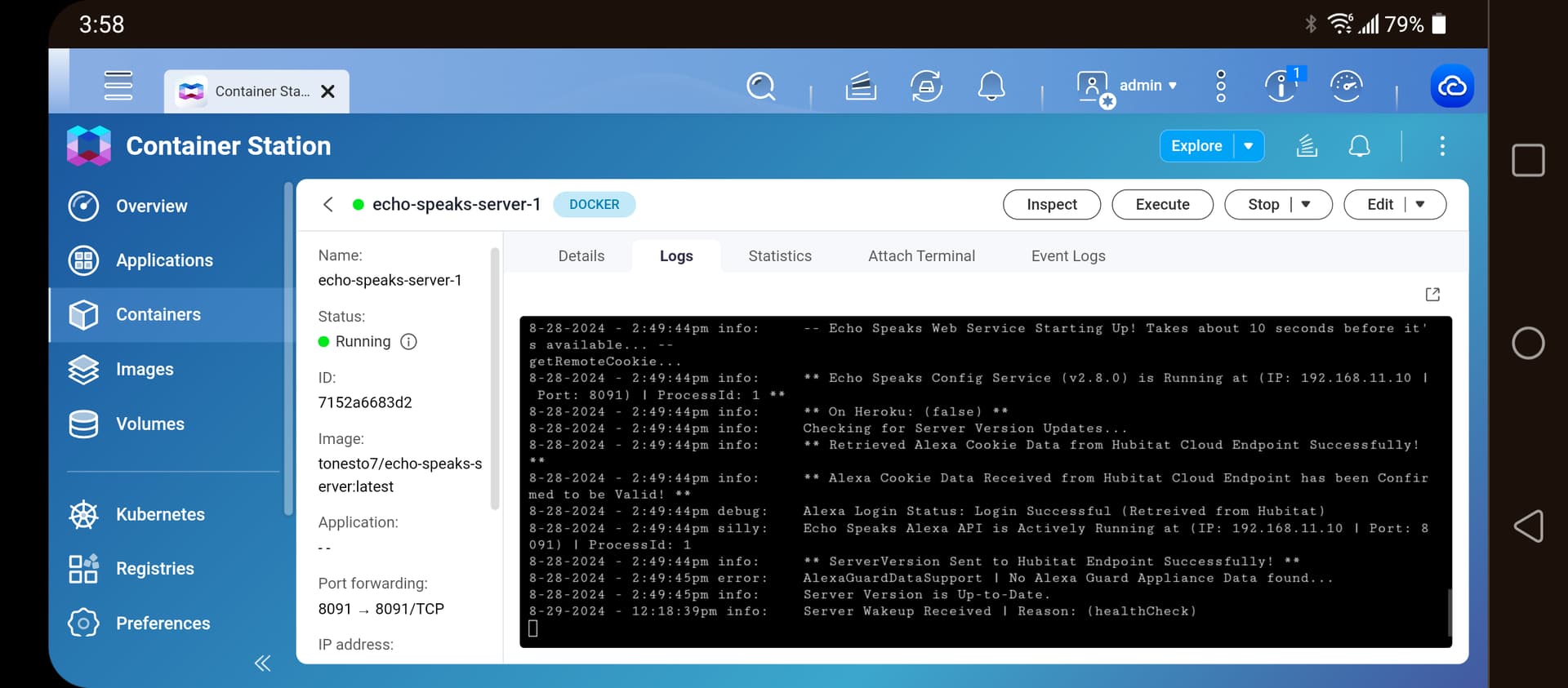

I didn't modify mine as I found a way to get my Qnap Container Station docker container to restart it.
On my qnap i dont see anything about it exiting?

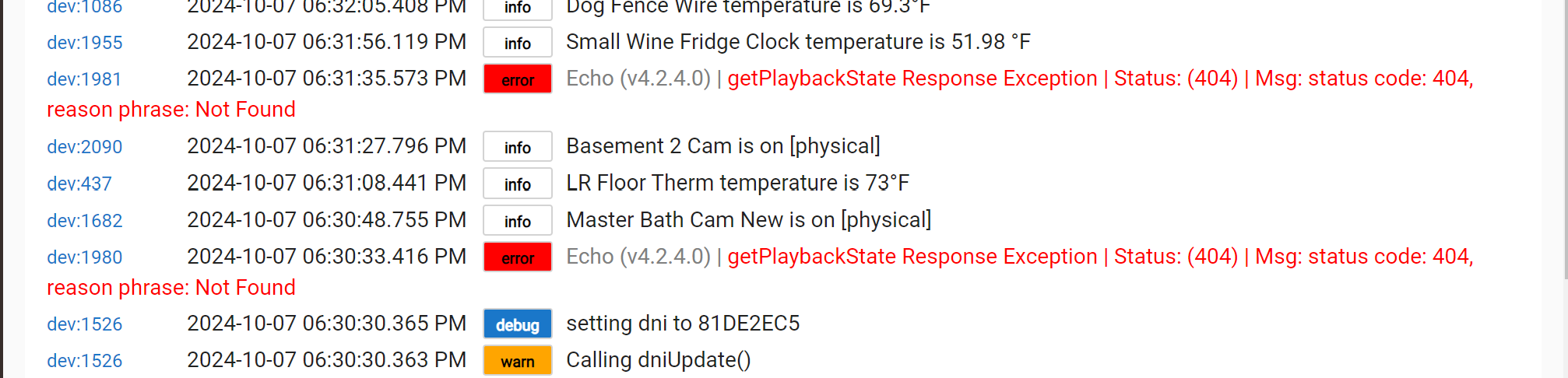

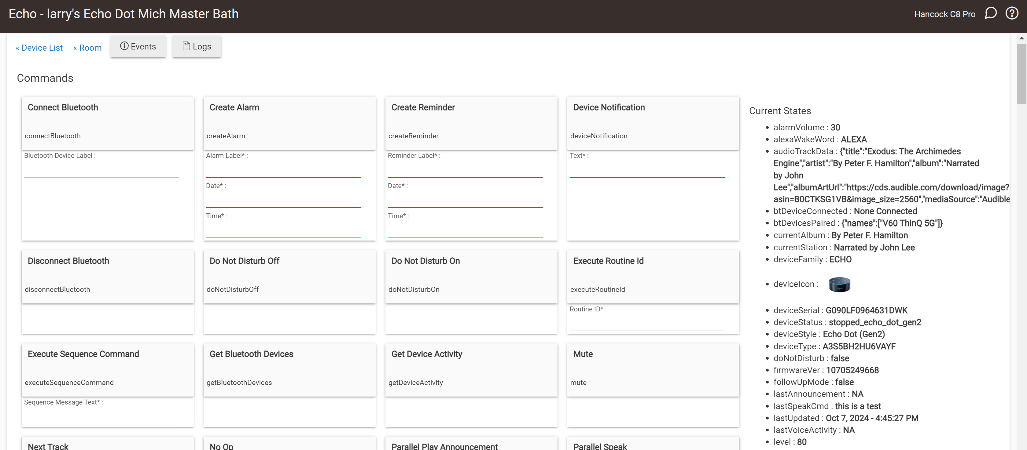

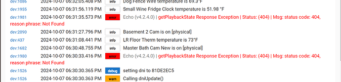

suddenly getting this error on two of my devices every 1/2 hour.. any ideas.. when i try a manual voice command it works fine so they appear to be functioning.
they are the ones i play this audio book on.. see below could it be something with the title having a url in it?

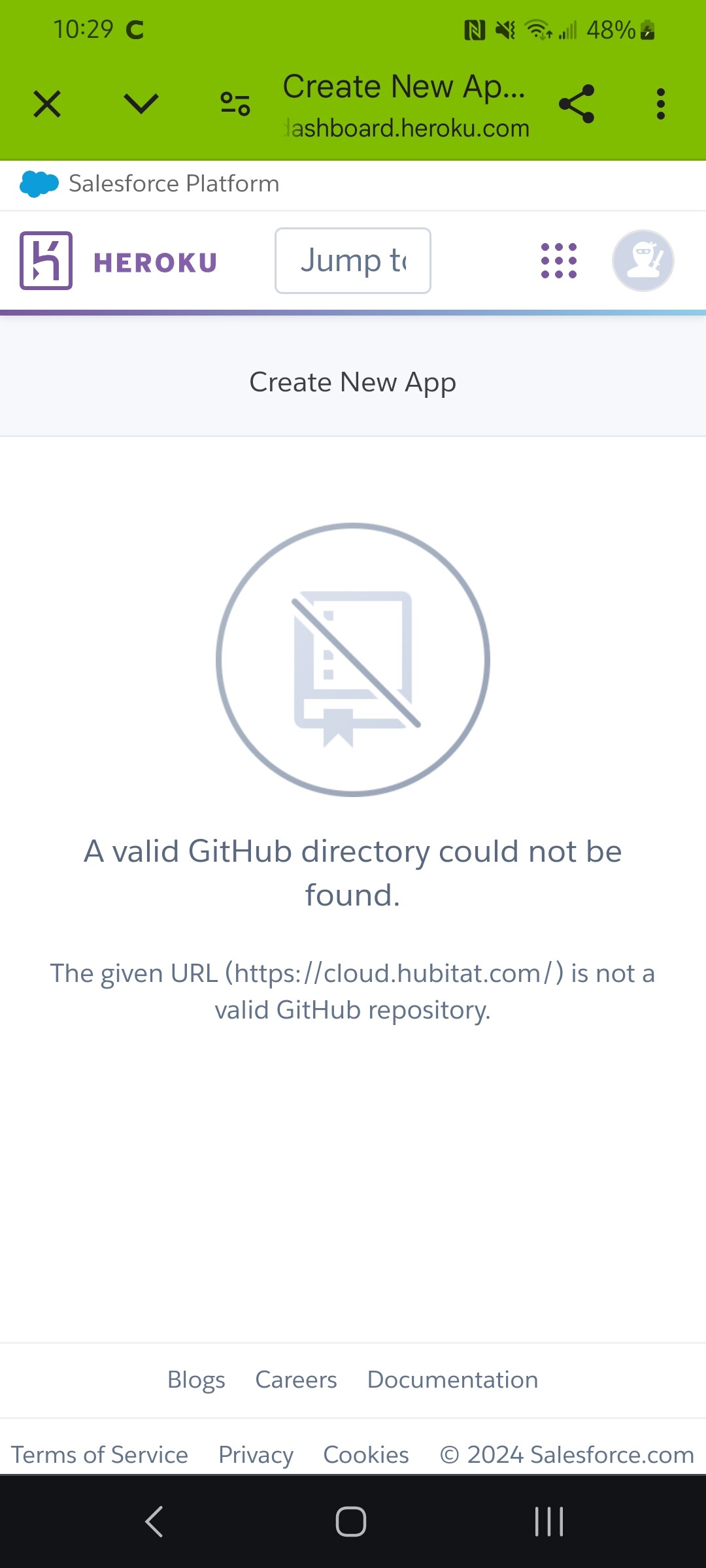

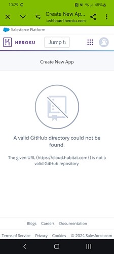

I am trying to install Echo Speaks on a new Hub, but when in Heroku server setup, after logging in to Heroku I get this error:
A valid GitHub directory could not be found.
The given URL (https://cloud.hubitat.com/) is not a valid GitHub repository.
what's wrong ?
Did you follow this guide? Echo Speaks - Heroku new deployment workarounds
thanks. now following.
