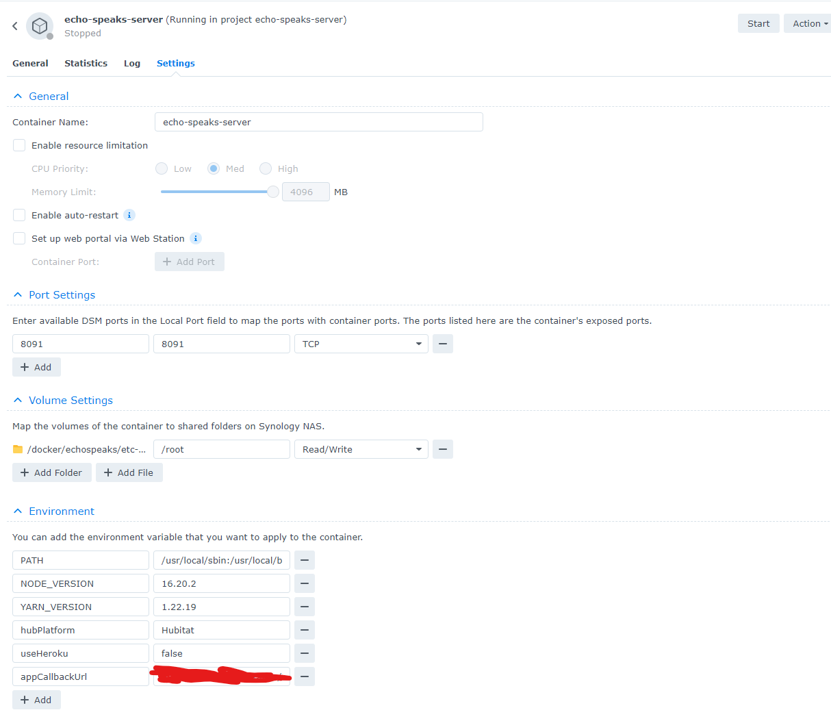

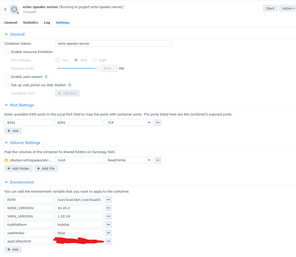

Once you have the YAML configured, build the container but don't start it. Once the container is built, go to Container in Container Manager and click on the ES Server container to open its settings.
Your settings should be similar to below. If you did not enter the app callback URL in the YAML, you will not see that setting, Save the settings if necessary and then click Start on the top right. That should be it. Now follow the directions for configuring ES.
@@@@@ I don't know why the YAML formats like that in this post. Just copy everything in between the start and end comments.

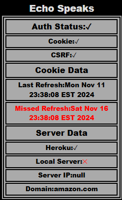

First, I'm running Hubitat beta firmware (2.4.0.119) - and I'm pretty sure this error started when I updated a couple of days ago. This is the output from ES tile HTML:

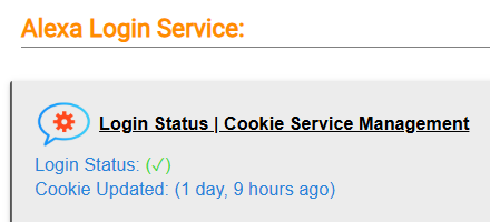

However, everything seems to be running OK and Echo Speaks shows this:

Mine is working, but I'll take a look. Are you on v0.0.5?
I wasn't, but I've now updated to version .5. Sorry about that.
At 11:00 EST, I then tried to 'Refresh' and then 'Refresh HTML'. I got these errors:
The HTML output has not changed:

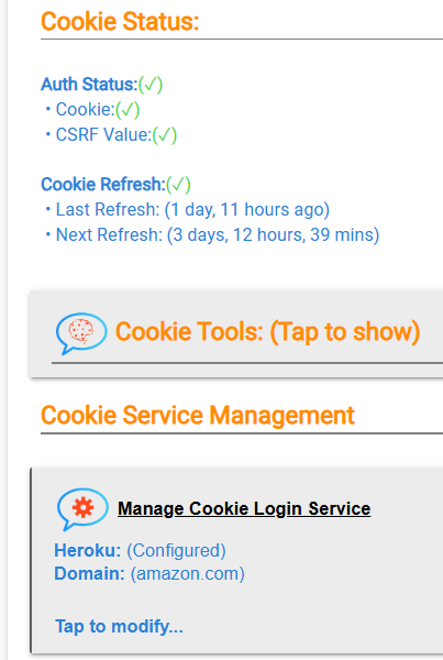

PS: Echo Speaks shows the following cookie status:
yep chalk it up to one of the many bugs in the entire interface rebuild in beta.. dont understand with the scope of the changes why people are running this on their live non development hubs.
