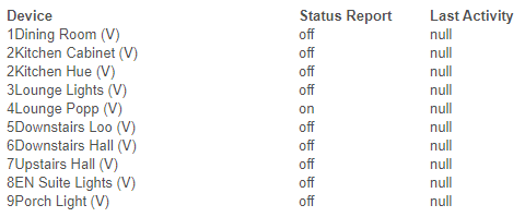

Hi @bptworld
I've just updated to 2.1.4 and I'm afraid I'm now seeing 'null' in the last activity field.
I have enabled debugging but no errorsd are appearing in the logs.

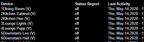

Hi Bryan.
I use the status option of this app as a confidence check that things are working OK when I'm away.
Would it be at all possible to have a colour option for things like "on/off" or "open/closed" for example.
Here is a screenshot of what I am talking about.
Like I say, it would be a "nice to have" but if it is not an easy change or you feel it is not really a good use case, don't worry about.
Just thought I'd ask.
Thanks. :slight_smile:
Sure, that's an easy one. Just time involved. Added to the list. :grin:
New version on Github...
Color Coding! Be sure to fill out the new section in the parent app and then go into the Status options in the child app.
I LIKE it :+1: :+1: :smiley:

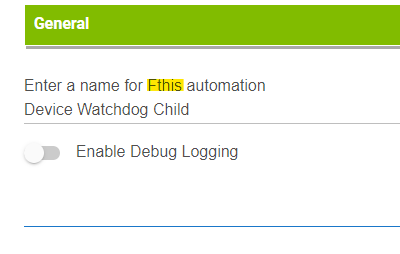

Just installed and start learning your app, noticed a typo.
Thanks, fixed
