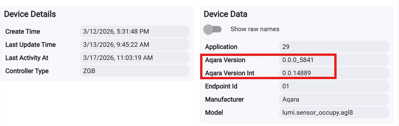

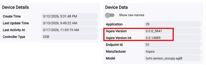

I have just published v1.0.10 with the change to provide firmware version.
Thank you very much, @hubitrep!
In order to populate the additiona firmware version data, simply update the driver, and then press the button on the device. That's it. Make sure you refresh your browser to update the data for the FP300 device to see the new information.

@hubitrep was kind enough to point out that not all of the Device Data fields were being populated, in particular the Date Code field. Thus, I have released v1.0.11 this evening.
I have tweaked the refresh() command logic to make sure the FP300 sensor is not overwhelmed with requests from the hub. This seems to have resolved Date Code issue. I have also removed the "Aqara Version Int" field as it really does not help the user know which Aqara Firmware version the device is running.
Note: In order to get the Date Code field to populate, you will need to wake the device by pressing the button on it, and then clicking the REFRESH command.
