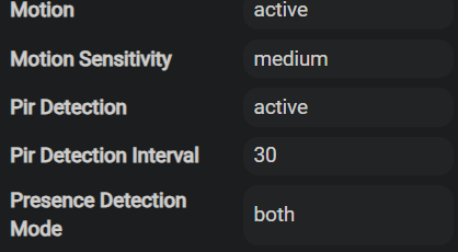

I pressed the wake button but I can't get Prefs to save.
Pir says both and sensitivity is still medium.

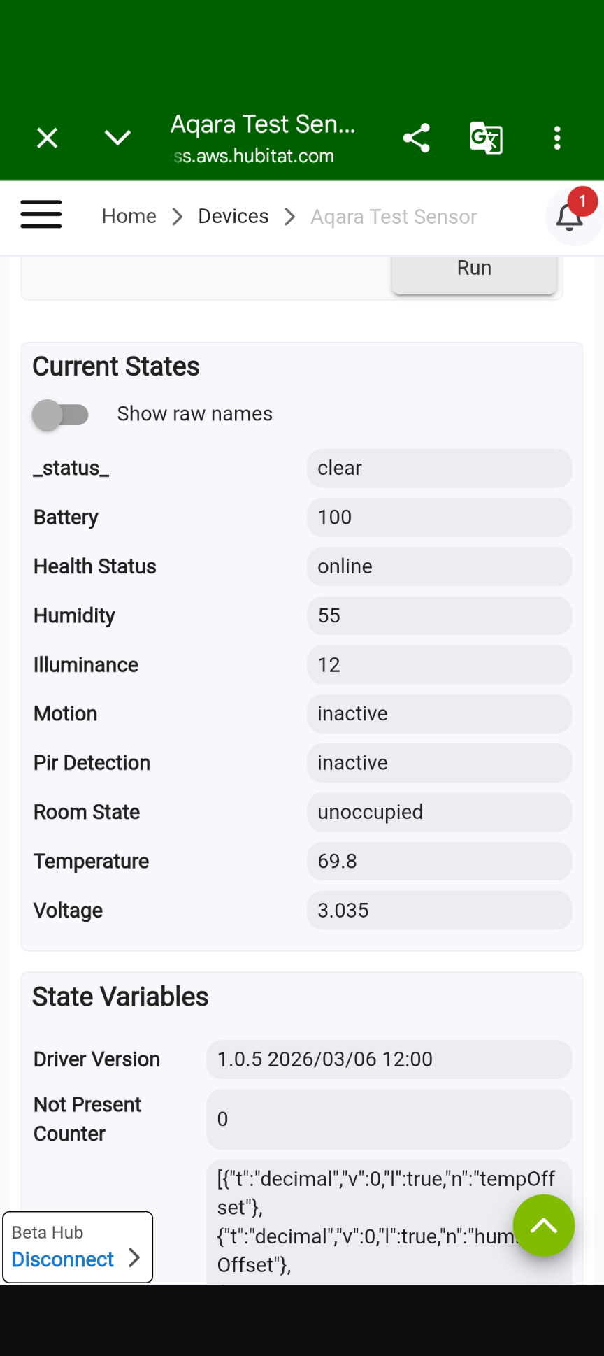

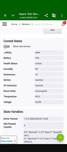

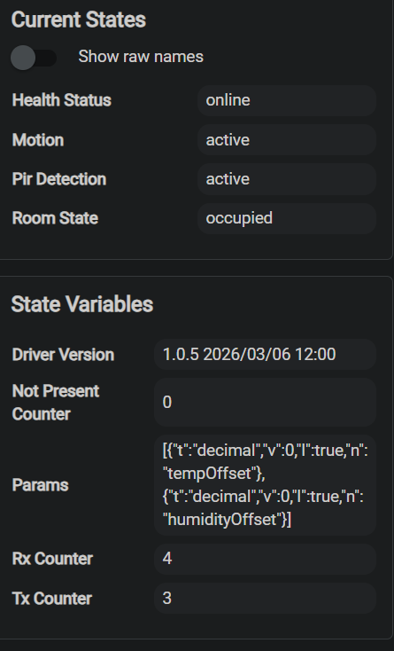

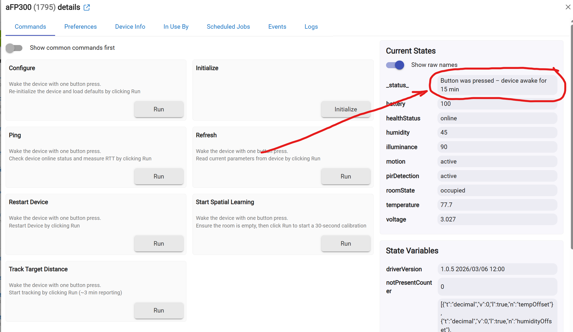

The current states screenshot you posted is different than what I see with the driver. Below is the screenshot from the driver with my device.

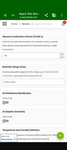

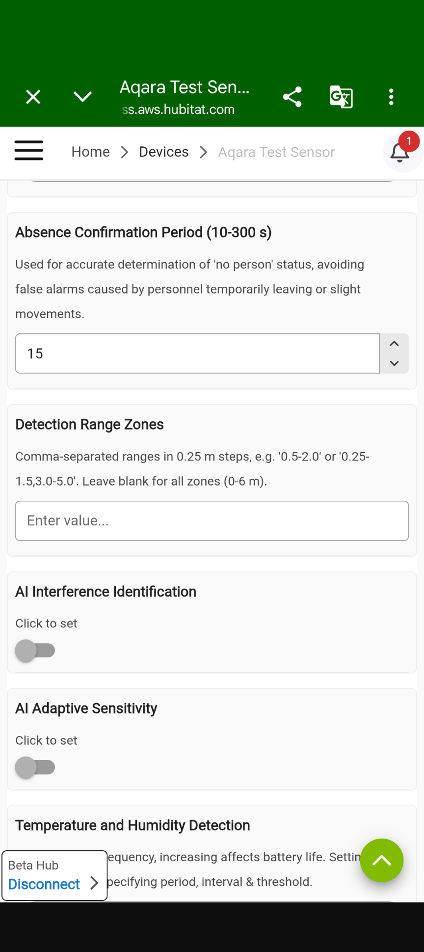

Also, you should a range in the preferences like the below screenshot.

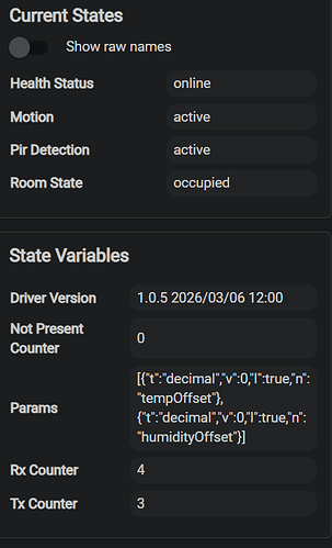

Let me hit this with the Device driver to wipe everything and start again.
It appears that you did not completely unpair/remove the device from your Hubitat hub before using the new driver. The new driver does not expose anywhere near as many custom 'attributes', and thus your old instance of the device will still show those old attributes, but will never update them again.
Those settings can simply be viewed on the Preferences page of the driver.
Many of the user preferences will only appear based on the value of other user preferences.
Which one(s) are you most curious about?
Indeed. I wiped the Current states.
Too much of a rush. My old P1 driver popped in before and I had to change it to yours but it was too late.

You should see the blue LED flas about 6-7 times after pressing (not holding) the button on the FP300. You will also see the _status_ attribute on the device's main page change to indicate that the button was pressed.

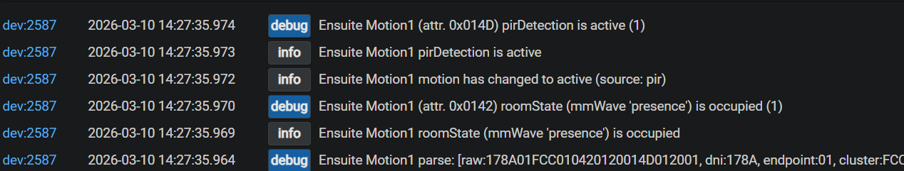

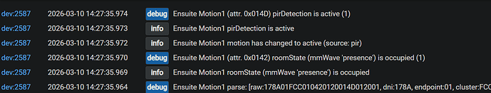

I hope @ogiewon doesn't mind me commenting. If I understand what you are asking, no the current name states will not changed based on PIR and mmwave. The PIR is of course what you see as PIR in the current states. The room state is the mmwave.
I experience about a second or so activation of PIR before the mmwave changes room state to occupied. However, "motion" becomes active as soon as the PIR is triggered. "Motion" will also stay active as long as the mmwave is detecting someone. It is possible and I have seen it that if you sit still enough PIR will go inactive but motion will stay active because the PIR is still picking you up. Then "motion" will not go inactive until both PIR and room state has cleared.
This means for 99% of users "motion" is the only state they will need to use.

I "assume' the mmWave room state is just populated by the Pir status, it doesn't actually mean the mmWave is active.
Does AI Adaptive Sensitivity now take over the low/med/high of the old driver?
No, the room state is the mmwave. It will not change to occupied until the mmwave is active. That is why PIR changes motion to active before the room state shows occupied. Then the PIR can go inactive and motion and room state stay active and occupied.
