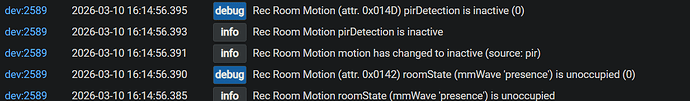

I lied. I'm back to the same old issue on Pir #1,2 and 3.
I blew out and set up #2/#3 again as I thought this was settled.
All went fine the after a bit I get the mmWave Occupied again so the Pir only didn't take.

I am not sure that the sensor will actually fully stop reporting PIR (pirDetection) if you select mmWave only. Or stop reporting mmWave (roomState) if you select PIR only.
Internally, the driver uses this pair of attributes AND the selected mode of Presence detection to determine the status of the Hubitat standard “motion” attribute.
IMHO, I really can’t understand why anyone would want to use PIR only, or mmWave only, instead of BOTH. The major selling feature of this sensor is that it combines PIR (for speed) with mmWave (for room occupancy) into a single battery powered device.

The User Preferences page is Data Driven now. If you select Presence Detection Mode of “PIR Only” and click Save, all of the mmWave-specific user preferences become hidden. Likewise if you select “mmWave Only” and click Save, PIR-specific preferences are hidden. The same holds true for the Temp/Humid reporting as well as the Illuminance reporting sections.
This is to only present to the user the settings that are applicable based on the current configuration of the sensor. This is exactly how the Aqara mobile phone app behaves.
