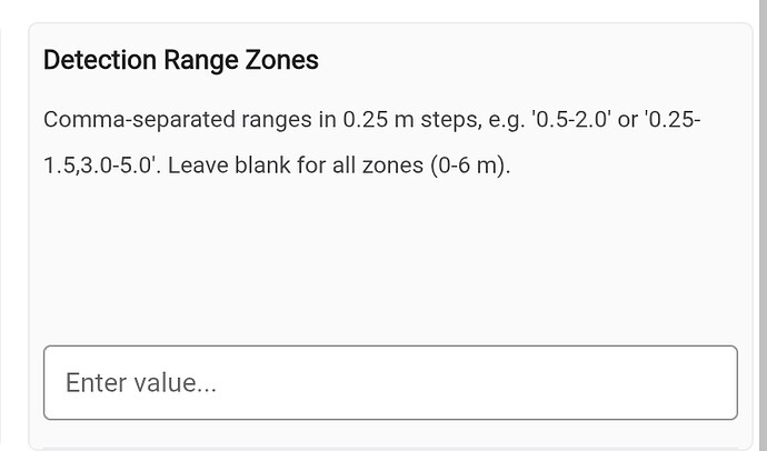

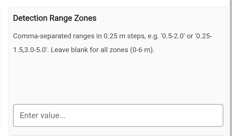

Btw, what the best way to restrict the range to say 5m max? I’m not clear on how that setting works.
So, from everything I am reading, the constant PIR detection IS a firmware issue.
For setting the range:
Put 0-5 in this block
You can also put comma separated ranges in: 0-1, 3-6 would exclude between >1 and <3 (like if you had a fan that was 2 feet away)
