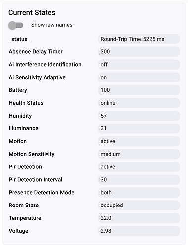

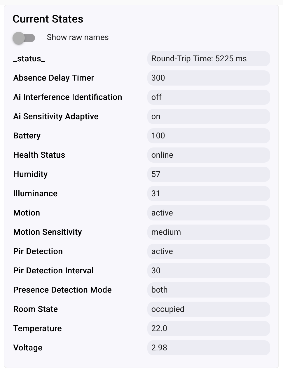

@ogiewon the missing info in Current States is definitely a code issue - I fed the FP300 and FP1 drivers to Claude and it was able to fix it:
Current States — the live attribute panel on the device page, populated only by sendEvent() calls in the driver code.
Preferences / Settings — the configuration inputs the user sets, updated by device.updateSetting().
When the FP300 reported back a confirmed value (like motionSensitivity = 2 or absenceDelayTimer = 10), the driver was calling device.updateSetting() to update the preference field, and storeParamValue() to save it internally for change detection — but it was never calling sendEvent(). Without that call, Hubitat has no way to know it should display the value in Current States.
Additionally, for an attribute to appear in Current States at all, it first has to be declared in the metadata block of the driver. Several of these settings weren't declared there either.
So the two-part fix was:
  1. Declare the attributes — add lines like attribute "motionSensitivity", "enum", ["low", "medium", "high"] to the metadata block so Hubitat knows these are valid attributes.
  2. Fire sendEvent() — add a sendEvent(name: "motionSensitivity", value: "medium") call alongside the existing device.updateSetting() call wherever the device reports a confirmed value back.
After a Refresh, the device sends back all its current parameter values, those now trigger sendEvent(), and the values appear in Current States.
and the result:
If you want the code, send me a PM and I'll UL it to GitHub. :+1:

You are right, most are useless, but my issue was I couldn’t tell when settings from the preferences screen had been successfully changed. Eg the AI and absence delay timer.
So we definitely need some of them to be exposed.

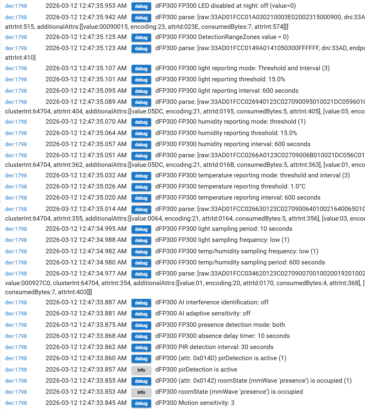

Here is an example of the debug logging after a refresh() command is issued. You can see the values of all of the settings. I am also updating those settings on the Preferences page. Hoping this will help improve things and it will behave more like traditional Hubitat built-in drivers, but will all of the features still available.
