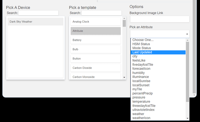

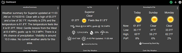

Hi Mattew, thank you for all your effort. I wanted to ask how I can add more "info" to the dashboard tile. I have selected Weather, then I have tried Attribute and selected weather, it just shows Clear. Then I select weather and weather and it show about 4 to 5 items. Also my weather icons are not working, I have this for alternate icon location GitHub - Scottma61/WeatherIcons: WeatherIcons for Hubitat Drivers.

There are three tile attributes that have multiple weather 'info' combined into a single attribute for use in dashboard tiles. Those are: 'myTile', 'threedayfcstTile', and 'weatherSummary'. Every other attribute is stand-alone, meaning if you want it in a dashboard, you can select it to display in a tile by itself. As with any driver, you select the 'Device', then for Template select 'Attribute', then the specific attribute you want to show in your dashboard.
Add as many tiles as you want to your dashboard.
