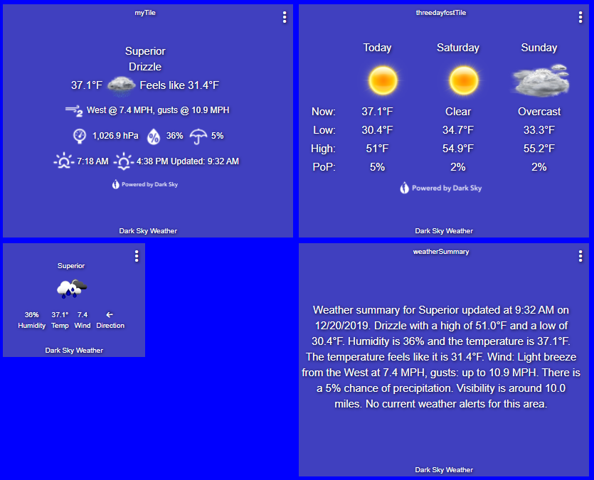

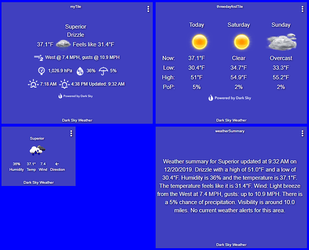

The default weather tile, myTile, the weatherSummary and the Three Day Forecast should all be in-sync when the driver polls the data from DarkSky. Mine looks like this:
The only thing I can recommend is to start from scratch, Remove the virtual driver and the driver code then reinstall the latest code and create a new virtual device and select the new driver code.
