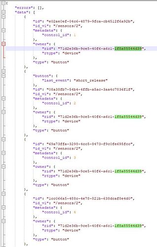

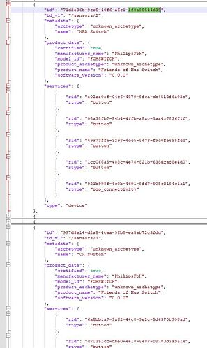

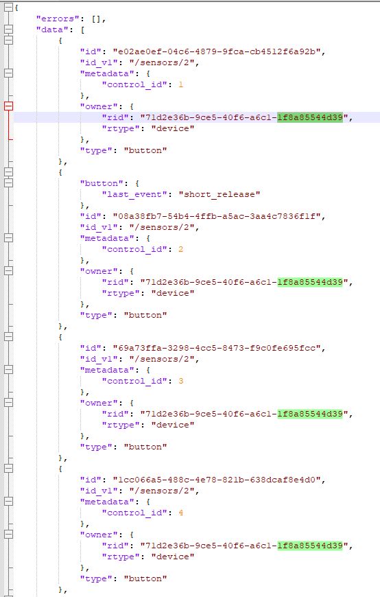

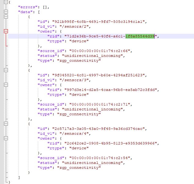

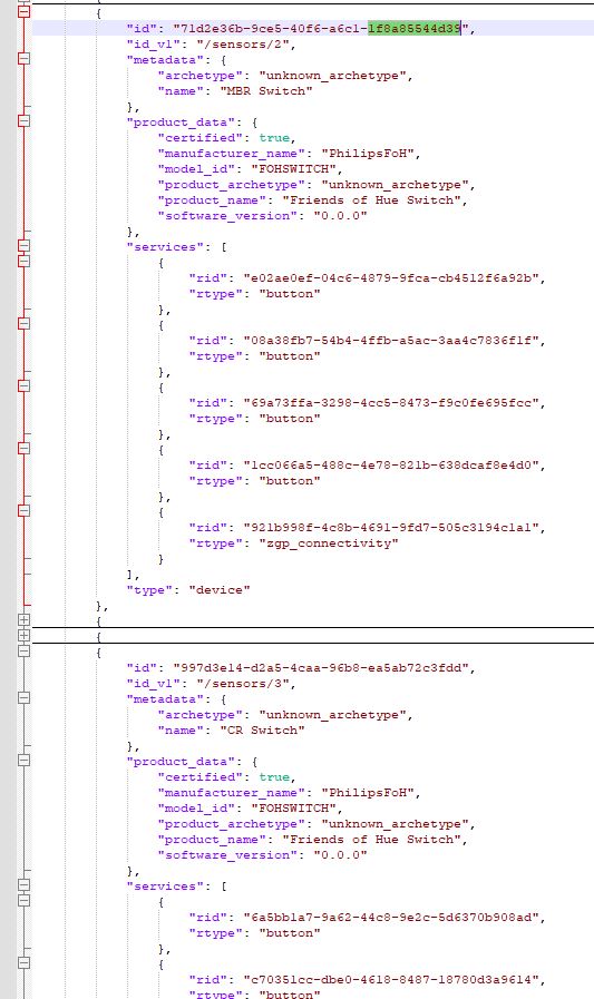

Here's the relevant info I got from the V2 API:
https://BridgeIP/clip/v2/resource/device:
https://BridgeIP/clip/v2/resource/button:
https://BridgeIP/clip/v2/resource/zgp_connectivity:

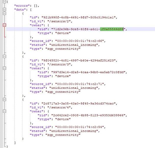

Is it those "source_id" values from zgp_connectivity you were missing? or the "id" values in zgp_connectivity? It seems to me like those could be the identifiers linking button events to relevant devices?
(note I have 3 switches, that all have 4 buttons on them each. I've called them "MBR Switch" and "CR Switch" and "LR Switch".)
EDIT:
looks like pressing the buttons just sends events with the owner ID and the button ID.. (an "initial_press" and "short_release" event), so I don't think the values in resource/zgp_connectivity need to be considered at all?:

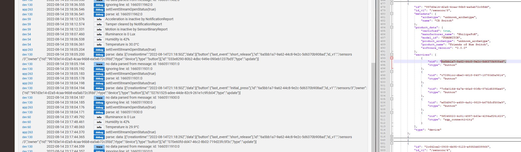

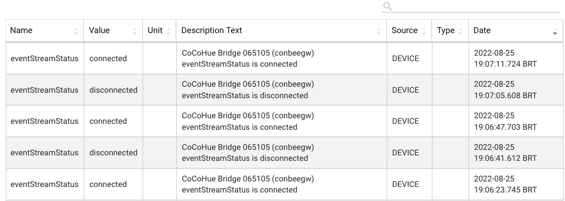

I started playing with it today and experienced the 5 second refresh page bug. Eventually I was able to paste the manual IP address of my Raspberry Pi 4 running deCONZ/Phoscon on a docker container and have it authorized in your App.
It seems to work, but I can see a whole lot of messages like the excerpt below on my log. Is this expected and normal?
TIA
Does deCONZ support a Hue API v2-compatible eventstream? Last time I looked, it didn't, though it did have its own way of pushing updates (not supported in CoCoHue because it was never part of any Hue system, though I briefly experimented with a fork that used it). That was a couple years ago and may have changed by now. But otherwise, I'd suggest disabling that option.
Regarding the question specifically, I don't think it should be normal, but for some reason it is for many people. :slight_smile: This is likely due to some oddity with Hue's eventstream implementation, the library Hubitat is using, or some interaction between the two. Nothing I try on the driver side seems to matter.
Thanks for you reply. @bertabcd1234
No, it doesn't seem to support the eventstream endpoint yet. :confused:

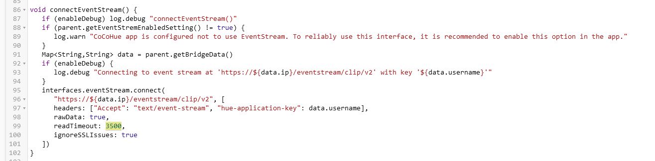

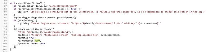

I was also having issues with the eventstream constantly getting disconnected and reconnecting.
I eventually fixed it by setting the 'readTimeout' in the CoCoHue Bridge driver to a larger value.
By default it's set to 60 seconds, which for some reason resulted in a disconnect/reconnect every minute or so. Setting it to 10 minutes resolved MOST disconnect/reconnects but now I just set it to roughly an hour.. and I don't have to worry about it anymore:
Yes my personal ZGP switches (Senic Gira) aren't listed by specific vendor name in Hue.
It seems Hue itself just has a list of all FoH devices that you have to select your specific switch from so I guess Hue internally also isn't able to recognize one ZGP switch from another, and relies on user identification.
In my particular case, for a double rocker switch (so 4 'buttons' total) the order for all 3 of my switches was consistent in how they got registered by Hue... which makes sense, given that Hue itself most likely relies on some sort of consistency as in the Hue app it DOES show an image of the physical switch and allows you to configure them like that.
From top to bottom in the v2 device's services list they were:
  • top left button
  • bottom left button
  • top right button
  • bottom right button
I'd hazard a guess probably most/all ZGP switches that work with Hue are setup the same way..

I've released CoCoHue 4.1 with the following changes:
  • Experimental support for button devices, per the above (requires v2 Bridge and v2 API/push option enabled in CoCoHue)
  • Eventstream tweak that may help with disconnect messages
