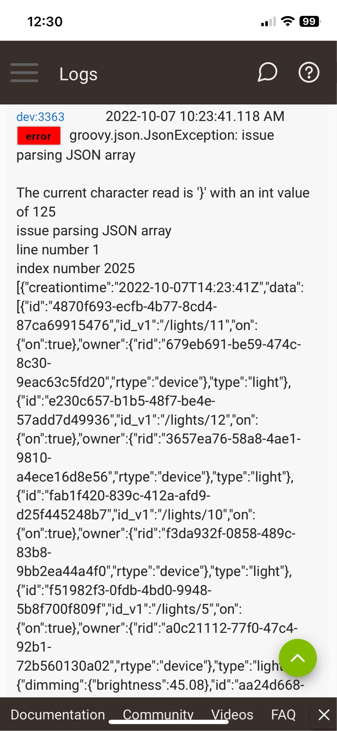

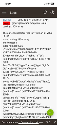

No new ones. I still see these on both Hue bridges:
Yeah, that shouldn't be causing this (though is still something related to either the eventstream interface on the hub or how Hue is sending this data, as far as I can tell). I'll keep an eye out on mine, though!
