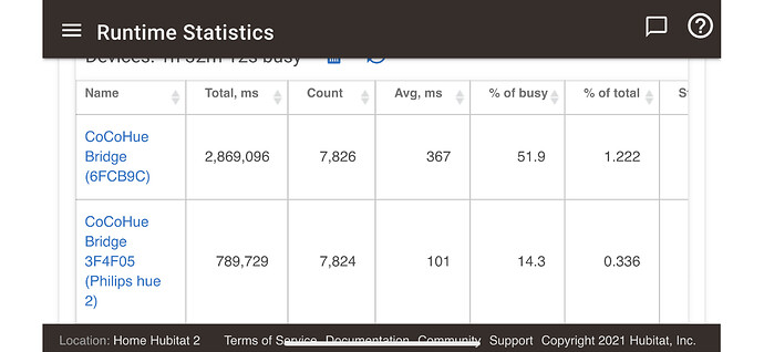

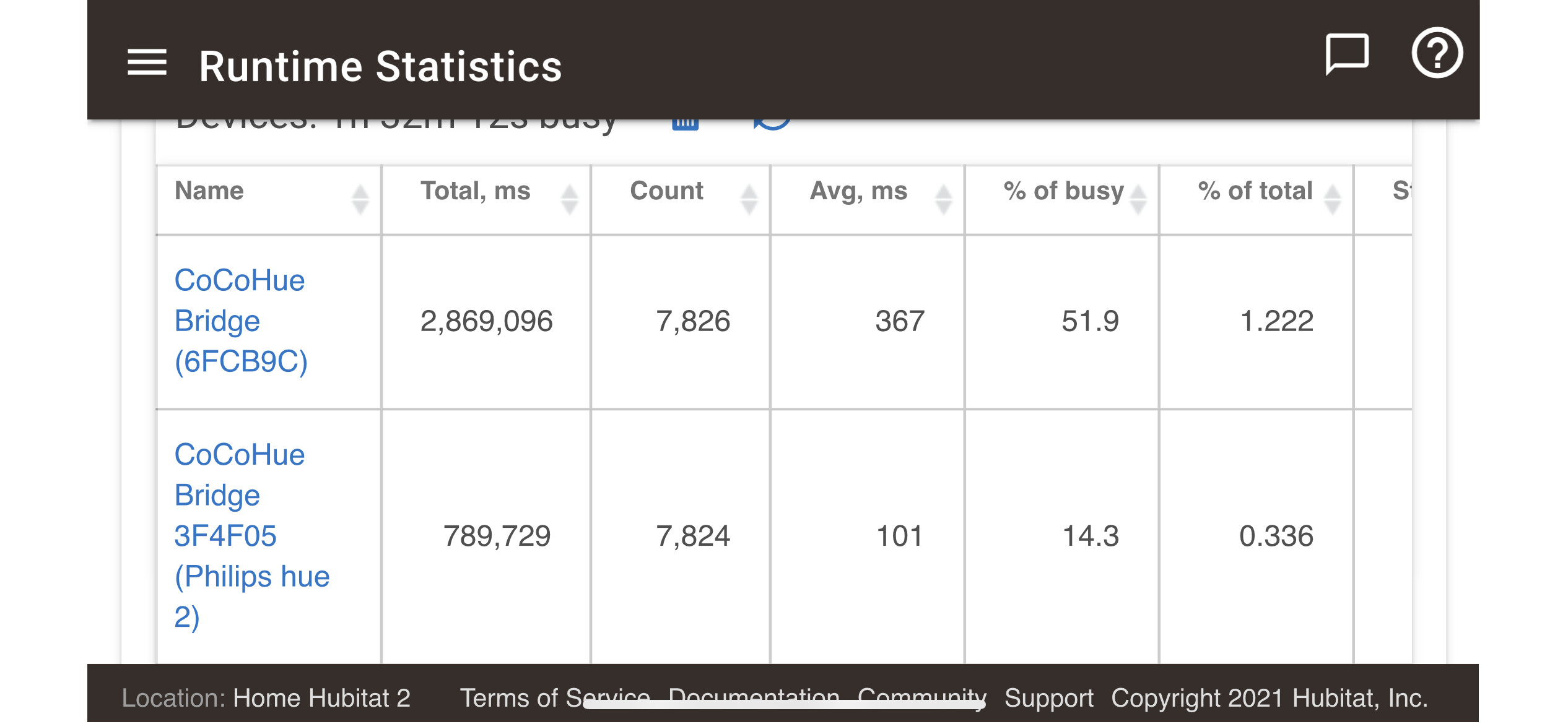

The percent of total for CoCoHue is pretty low for the device (the second/app screenshot is actually Chromecast Helper :slight_smile: ), which personally wouldn't have me too concerned. The percent of busy just means that among other running drivers/apps, it's responsible for more of that time--which isn't too surprising given that it relies on polling to get device states (so it runs on that schedule, not just when actual device events happen--the current Hue API does not provide a way to send that information to Hubitat as it happens, but maybe soon). Most apps only wake for device events, and most devices only run code when something actually happens (e.g., you run a command or the device sends something to the hub).
If you are noticing problems, you could consider taking steps like reducing the polling interval, which is the main thing that contributes to this usage. Otherwise, I don't want to tell you how to interpret your own hub's stats, but again, they don't seem too concerning to me personally.
This is what my two bridges show and I have never had an issue with this hub
OMG ..Sorry about the wrong post of ChromeCast Helper..Sounds good. Thank you both for responding.

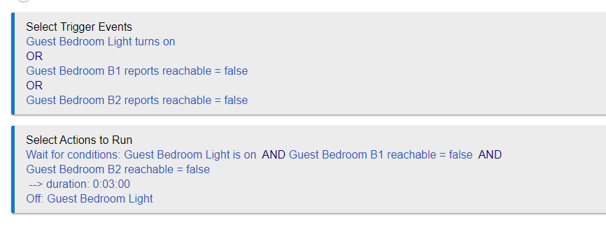

Just realized I never posted this and I also came up with a better rule using RM5. The "Light" is the bulb group from Hue, which contains these two bulbs in the rule. The idea here is if the bulbs are unreachable for 3 minutes then we assume power was cut (by the switch) and they are off. So in that case I am forcing the group to be off, so that it shows as off on any dashboards or reports, etc...
The reason I also have a trigger for the group turning ON, is in case someone does try to turn it on from a dashboard while the power is cut, which obviously wont work but the group would normally stay ON in that case, so this rule would wait the 3 minutes and then turn it back off if the bulbs stay unreachable.
I have seen where one bulb will randomly go unreachable and then come back on the next poll. Due to this requiring both to be unreachable and also the 3 minute wait I have not had any reports of it unexpectedly turning the lights off when they were on. Seems to be pretty robust.
