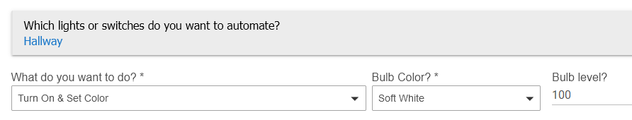

Hello,
With the latest update, whenever I have a command to "set level and color", like this:
I get the following error:
org.codehaus.groovy.runtime.InvokerInvocationException: groovy.lang.MissingMethodException: No signature of method: user_driver_RMoRobert_CoCoHue_Group_303.getScaledRGBTransitionTime() is applicable for argument types: () values: (method setColor)
Anything I can do? Thanks!
I believe I have found and fixed this problem. I have updated the group driver to version 3.5.2, available in HPM or manual install. Thanks for the report! (For future reference, the driver in question would be helpful to know--this is what I found after looking around for a bit, so let me know if it's not right!)
Also, if that is an app like Rule Machine, Button Controller, or SAR (and your bulbs aren't RGB-only like the first-gen Hue Lightstrips or certain Ikea bulbs), I think you will be better off with the "Set Color Temperature" action and specifying a color temperature around 2700. The "Turn On & Set Color" action, despite the fact that it lets you select "Soft White," uses color/RGB values rather than color temperature, and it's a poor approximation on most bulbs.
Pulled the update and the error disappeared. :+1:

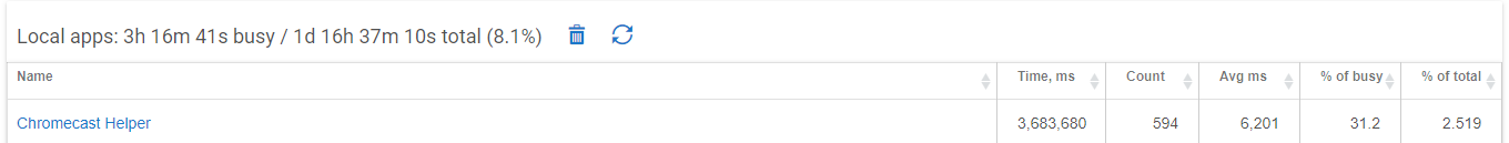

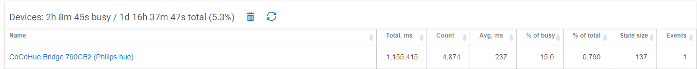

Seeing CoCoHue is very active in Runtime Statistics. Anything to be concerned about?
Device Stats:
App Stats:
