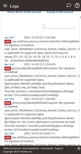

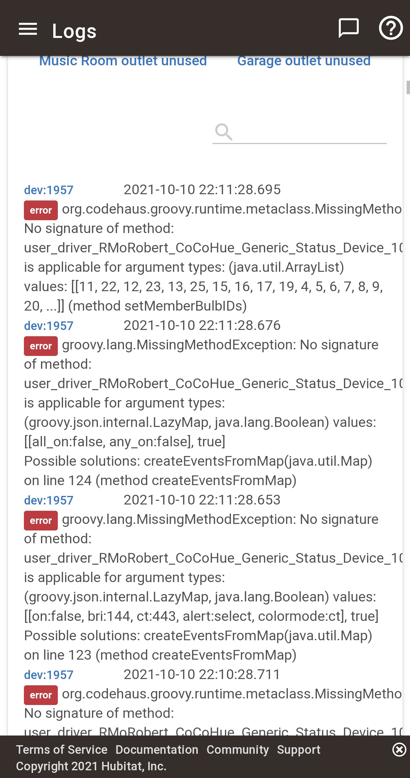

Hi @bertabcd1234, not sure what's causing this but a specific group is causing 3 errors in the logs at each time the bridge is polled.
Sorry if this has been asked before.
Any clues?
Do you have Group devices that are using the CoCoHue Generic Status driver instead of the CoCoHue Group driver, by chance? If so, switching those (and making sure the code is up-to-date) should help. Someone else had that problem recently, so I'm not sure if either that is just an easy error to make for some reason if you're copying/pasting code or if I maybe messed something up in the HPM repo at some point (if you're using HPM)...either way, that definitely looks like what's happening.
You are absolutely right, that specific device was using the Status driver. I just changed it now for the Group one.
I do use HPM, and I never changed that driver manually. For some reason it was incorrectly assigned when I added that group.
Anyway, it was an easy fix :blush:
Thank you!
Interesting! I just tried adding a new (previously not added) group on my test hub and was not able to replicate the problem. If it keeps happening or you figure out some pattern to if/when it does, let me know and I can dig into it more! (To be safe, I'd recommend a re-match before you update next with HPM--just in case it happened to associate the wrong driver name with some driver code.)

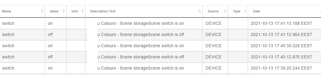

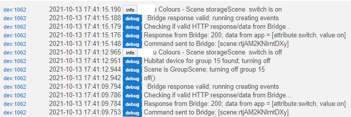

Just to let you know, that hue labs scenes do not work with cocohue and can't be controller from Hubitat. So none of the color transition scenes can't be used. I'm guessing that what ever it is that prevents this has same root cause for the hue labs and for the HueEssentials.
There is still something that works and that is turning scene off. So if scene is started from hue app (labs section) and scene is migrated to hubitat with cocohue, then it is possible to turn scene off once it is started. Scene cannot be started from Hubitat.
Log is active though and everything seems to "do" right things..
Device log react only when Hubitat scene device (virtual on and off) is pushed but on doesn't really do anything.
So, turning "off" a scene really isn't anything special, and I'm not surprised that that works; it just finds the associated group or lights and turns those off. (Hue does not have a concept of scene on/off states, at least in their current API; they are just activators. Part of me wishes I never made them switches, only buttons, on the Hubitat side, but I added reasonable-seeming switch behavior based on feedback from a particularly vocal former early adopter.) The "scenes" you're using that don't work to turn on/activate must be using additional parts of the API, perhaps multiple scenes plus schedules, to do their work, which won't work with CoCoHue at the moment.
