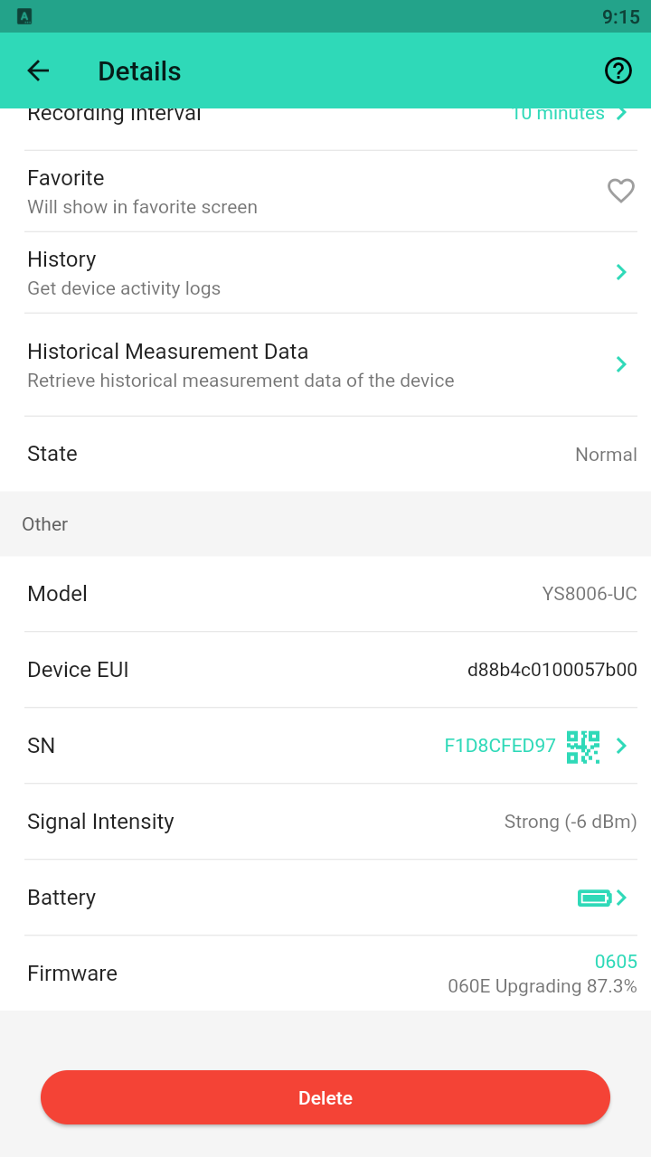

If you have any X3 sensors, make sure their firmware is updated to level 060E:
According to what I've read, the sensors normally report every 10 minutes. They are supposed to report more frequently if temperatures are quickly changing over a short period of time. There is no way to programmatically simulate the "refresh" icon in the app to force a refresh.
Thanks for the reply. I went through my devices in the app and noticed that some had a firmware update available. So I updated them.
As an aside there doesn't appear to be any way to turn on automatic firmware updates and/or see all available updates without going into the settings of each device?
As it happens, none of the temp sensors in question had updates available.

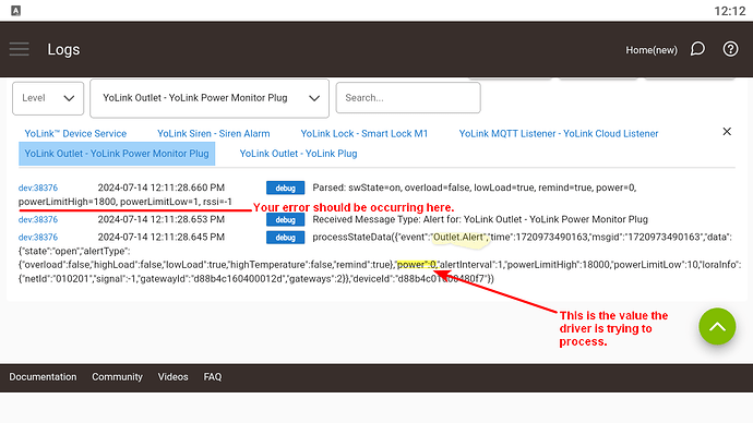

Hi, I am getting this error over and over again.
java.lang.NullPointerException: Cannot invoke method div() on null object on line 481 (method parse)
This is for one of my YoLink power monitors. Do you know how I can fix that?
This error is occurring when the driver is trying to process an alert from the outlet. The outlet is not reporting some of the expected power values. Please make sure you're running the latest firmware on the YoLink Outlet and on the YoLink hub (use the YoLink app to view and update the firmware, if necessary).
If the firmware on both are up to date, open the power outlet device on Hubitat and set Debug to True. Look in the Current Hubitat log and wait for the error to occur. Send me a screenshot of the lines like these:
