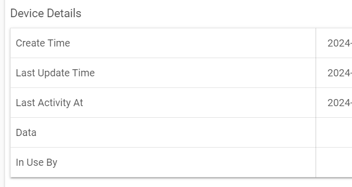

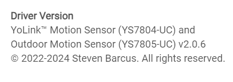

@SteveBarcus, I just tried to connect to the outdoor motion detector. I created the device OK,and from your list of supported drivers it appears I have the right one, but all I see under Current States is the driver number.
The device works fine in the YoLink app. Any ideas?
One thing I just noticed is that the motion sensor doesn't seem to have a parent app listed. The other YoLink devices do.
My suggestion:
- Run the YoLink Device Service app, unchecked the motion sensors and run the app to completion.
- Insure the motion sensor devices no longer exist. If they do, use the "Remove Device" button on the devices to remove them manually.
- Run the YoLink Device Service app again, rechecked the motion sensors and run the app to completion.
- Check the logs for any unusual errors or warnings.
- Look at the motion sensors again and insure the parent app shows.
I followed your directions exactly and everything worked. Thanks for your help. The error was mind somewhere along the way.
You're welcome. Glad it worked for you.
