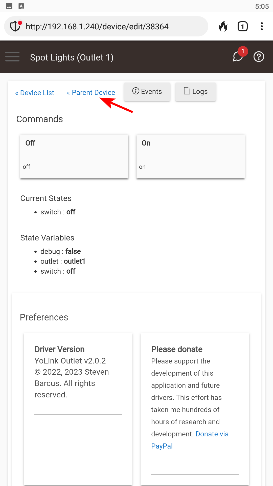

Is there anyway to change the name of the outlets in the multi-outlet. I am using the outdoor outlet and have changed the name of one in the Yolink app but it doesn't reflect in Hubitat nor does there appear to be a way to rename them as they don't display as child devices. Thanks.
The outlet names from the YoLink app are not sent to the Device Service so they can't be changed on Hubitat that way.
You can change the names through the Outdoor plug device on the Hubitat:

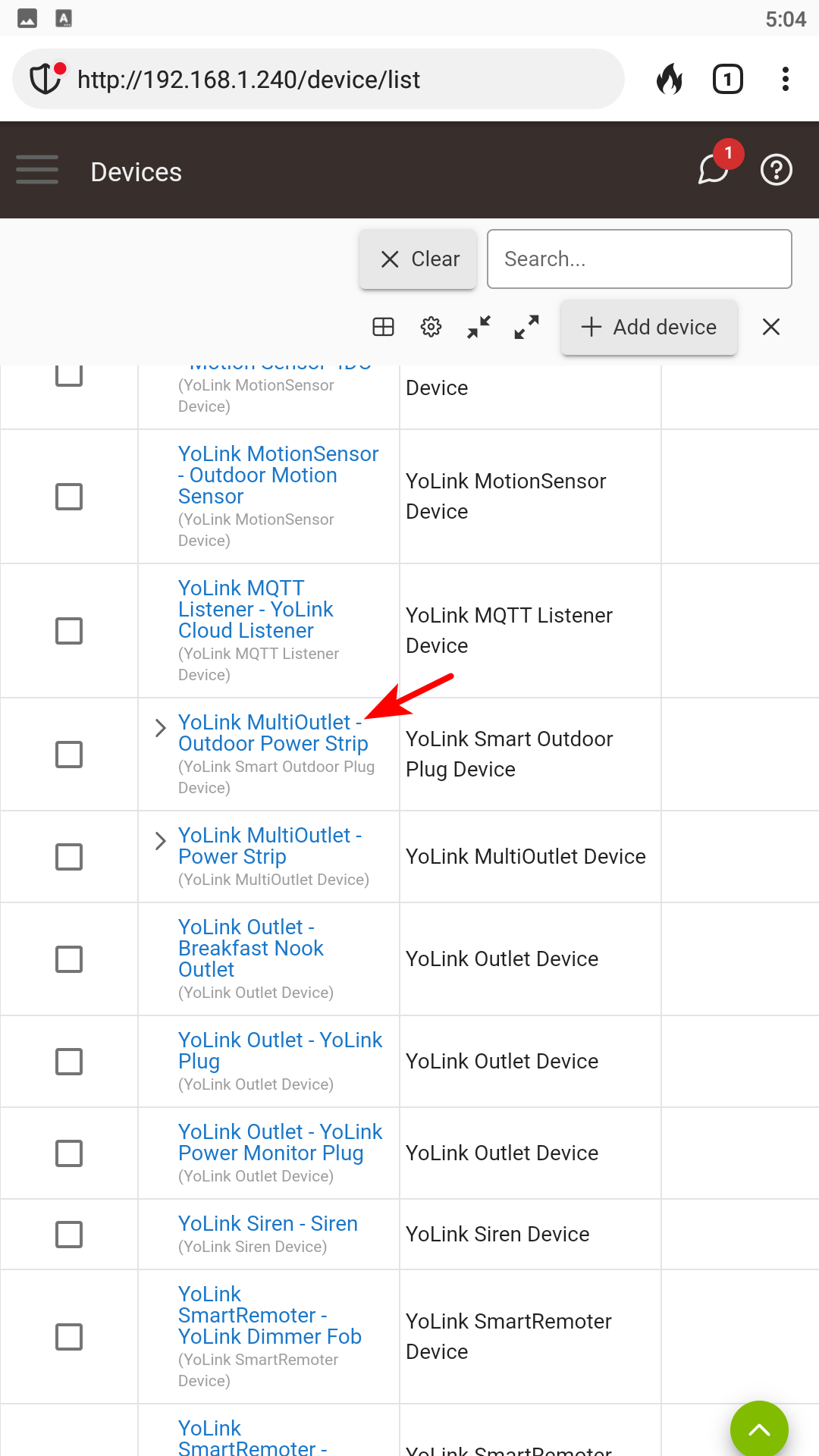

  1. Open the Devices on Hubitat and click on the Outdoor Plug Device:

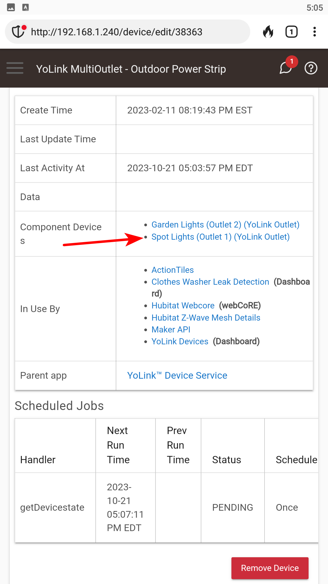

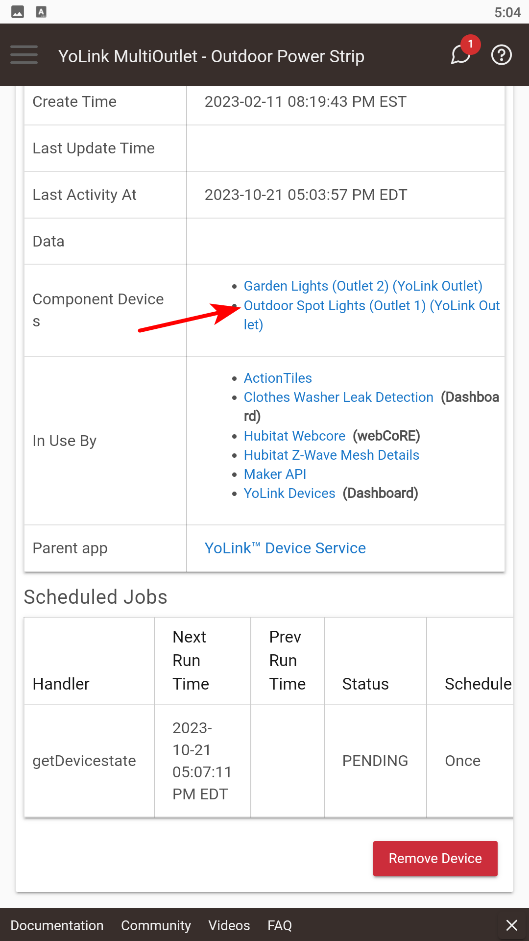

  2. Scroll down until you locate the Component Devices, i.e., the outlets, and click on the one you want to rename:

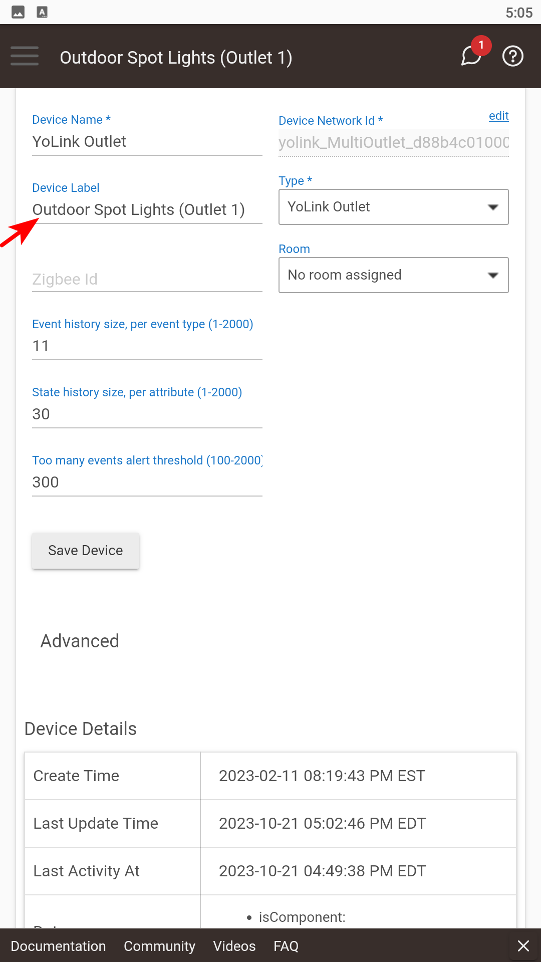

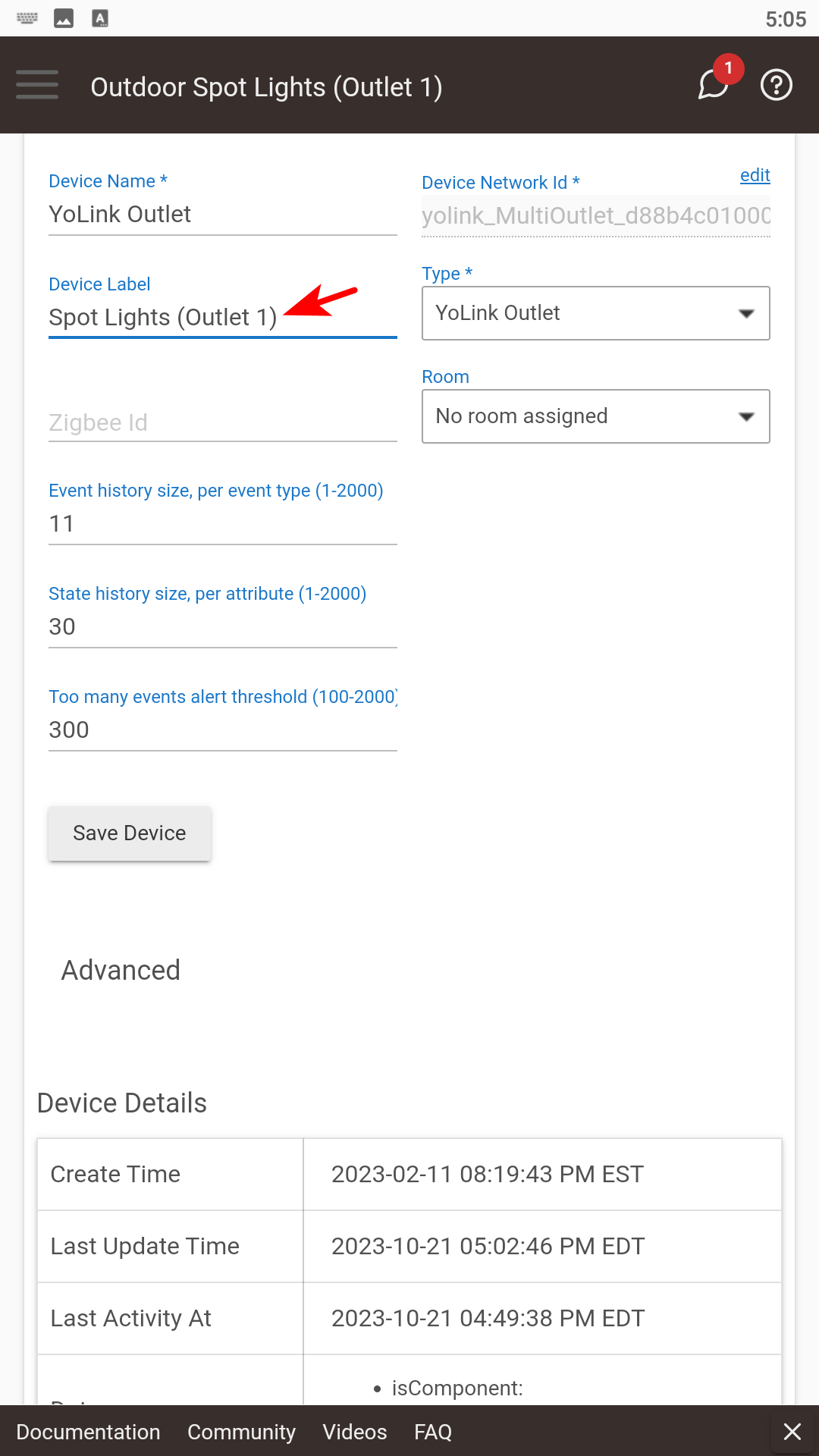

  3. Scroll down to the Device Label:
  4. Change the Device Label and then click the "Save Device" button:
  5. Scroll to the top of the Device and click on "Parent Device":
  6. The Device should now show the new name:

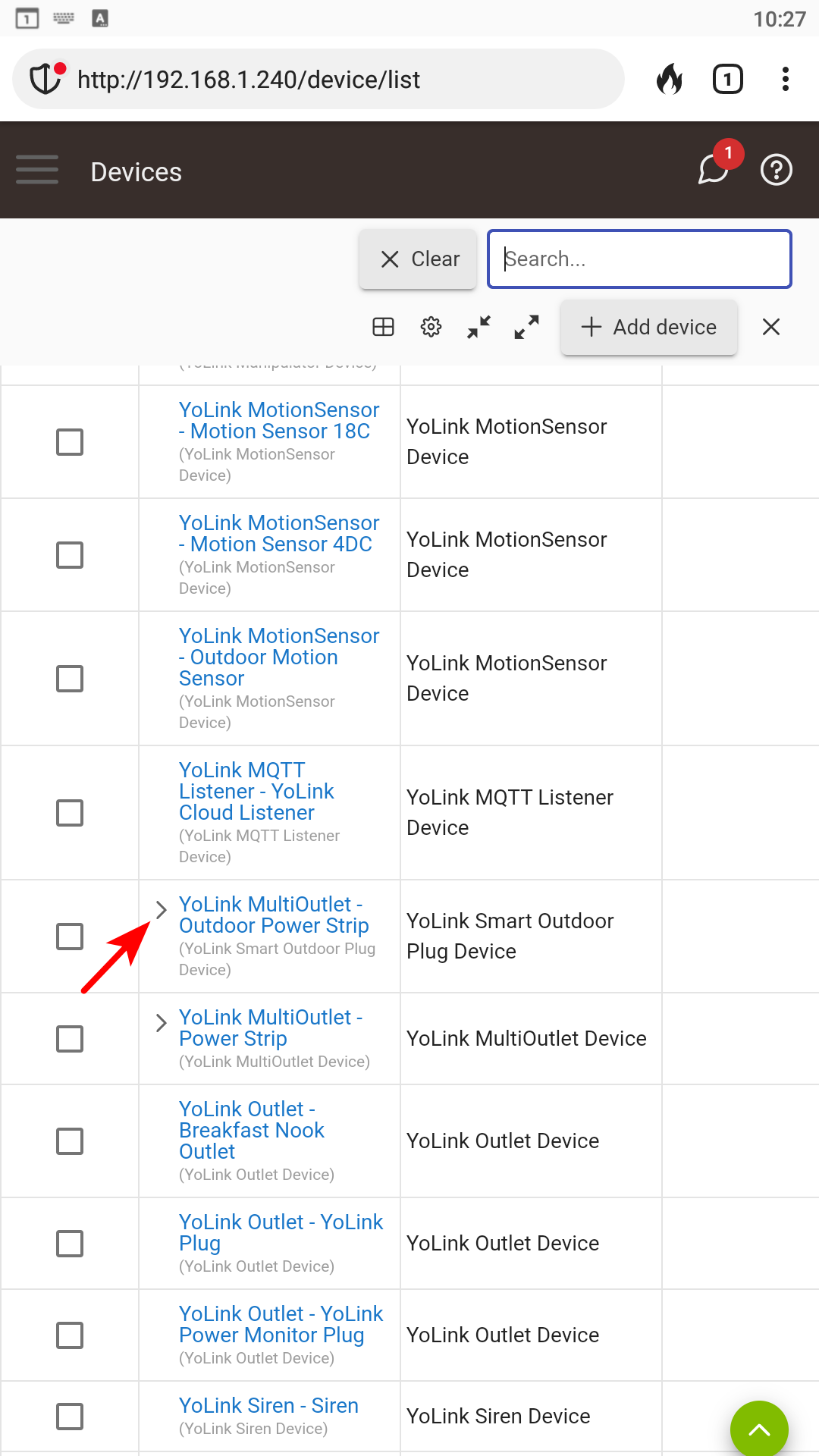

Alternatively, you can click on the drop-down arrow on the device:
Then click on the outlet device to access it.

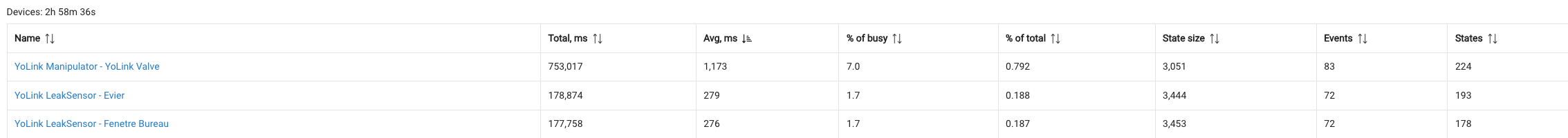

Hi @SteveBarcus,
While gathering metrics from the hub, I noticed that the YoLink Manipulator device I have is by far the most time consuming device I have
Alone, it uses up 7% of all of the busy time, with an average call time of over 1 second per event. Yet, this is a device that does nothing unless it is actionated.
Do you know why it requires this much time to process each event ?
I just added a few devices to my yolink hub. I ran through the setup again in hubitat app and checked off the new device but they don't seem to show under devices in hubitat
Thoughts?
Each time a Manipulator device is polled it reports back more information on its status then the Leak Sensors do. This requires more processing.
The Manipulator driver handles a lot more work than the Leak Sensor driver in response to changes via the YoLink app. For example, any time you make a change to a schedule, the driver is notified and then it must make a call to the YoLink cloud to get the new schedule.
You can display the Manipulator device on the Hubitat and then use the "Events" button to see what is driving the work. My Manipulator's signal strength seems to be very variable vs the leak sensors which causes additional work to constantly update the values. Also, look for any other overhead events like reporting events to dashboards.
Lastly, you can increase the polling time in the Device Service app to poll slower.
