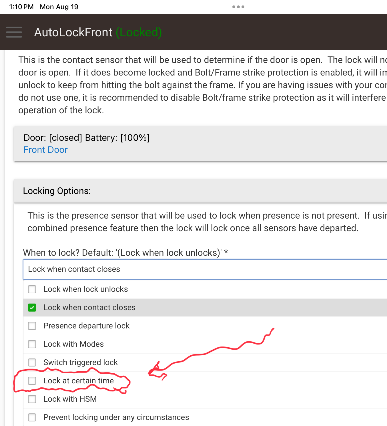

Just guessing but do your locks have both a Label and Name?
Educated guess, in the child groovy code the lock is variable “lock1”.
In most messages it is used as ${lock1}
BUT, in some messages it is ${Lock1}
Change Lock1 to lock1 and give that a try.

Yes my locks have a label and a name
Yep and if running the original version it is an issue. There is git pull addressed this in Jul 25, 2023 by DanielWinks https://github.com/heidrickla/Hubitat/pull/2
