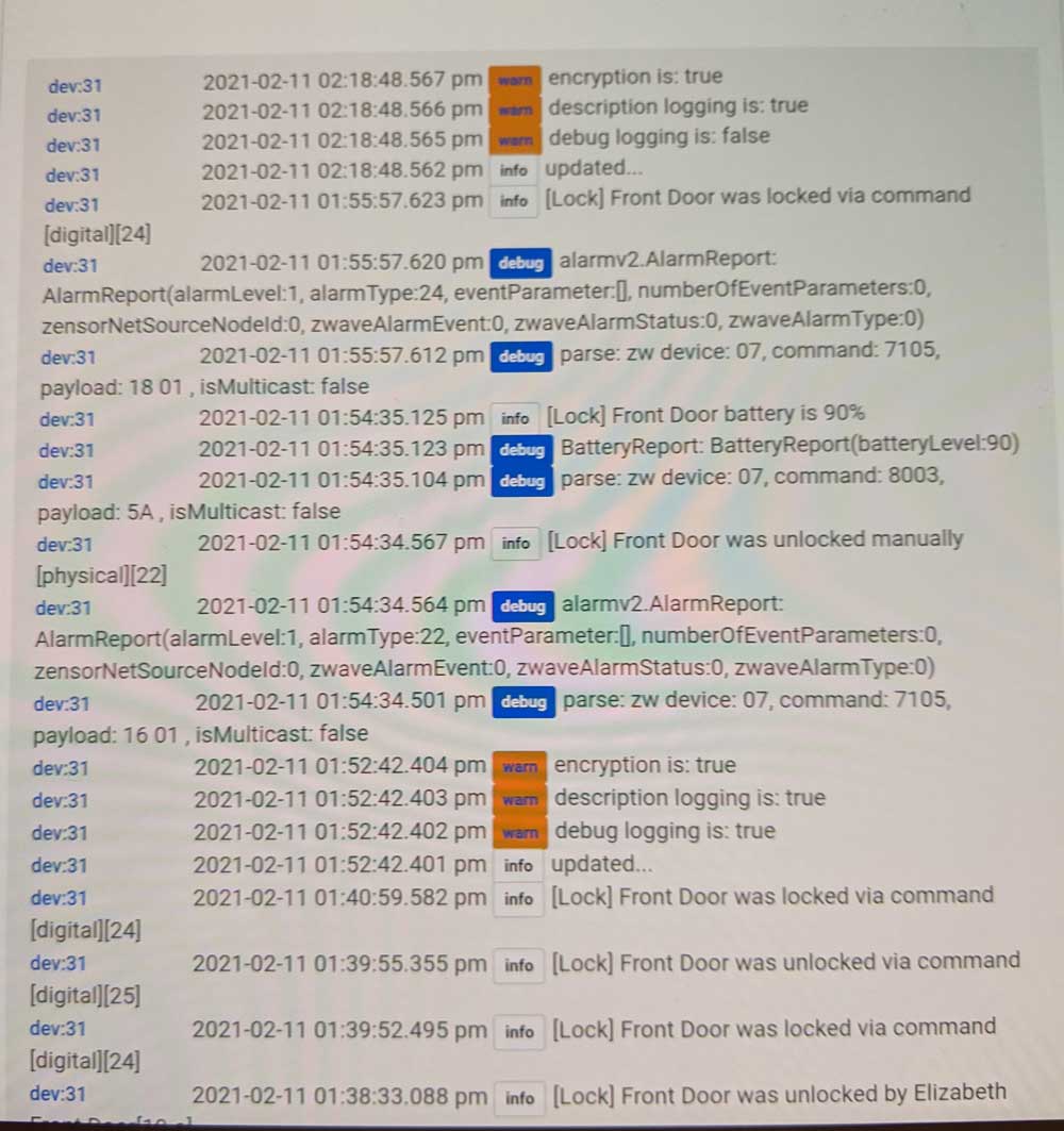

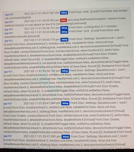

Done and here is the log of the lock at the same time of the previous screen shot.
Did the code I posted get rid of the error? Wife started getting irritated at me repeatedly locking and unlocking the door trying to get an error with the new code, but I wasn't able to replicate the error with the new one. I did see it on the old code though.
I am not seeing it either now.
It was hard to generate on my network but I could trigger it by saturating the mesh with commands and then trigger the lock such that it would fail and try to retry. Pretty sure that it's taken care of but wanted to make sure since I had to do some weird stuff to get it in the first place. I'll post it to github and up the rev so it goes out as normal.

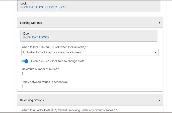

I'm currently using v1.1.32. I recently noticed the locks were not locking and while checking into the problem I noticed I can no longer find the setting that was used to set the delay for relocking. I was using 10 minutes.
Has there been some changes in the app that I need to reconfigure my original settings? I was having the lock auto lock after 10 minutes between the hours of 11 PM and 7 AM.

But I can't seem to get any of the notifications. I tried turning them all on, and the only one I got was on unlocking I got "Front Door (unlocked)Maximum lock retries reached."
I also see this in the logs:
2021-02-17 12:39:18.570 pm errorjava.lang.IllegalArgumentException: Name cannot be null. on line 825 (retryLockingCommand)
