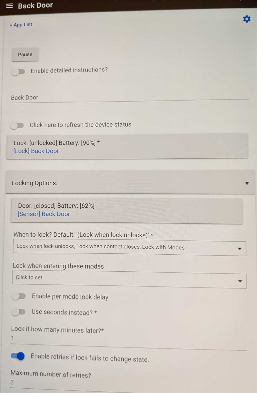

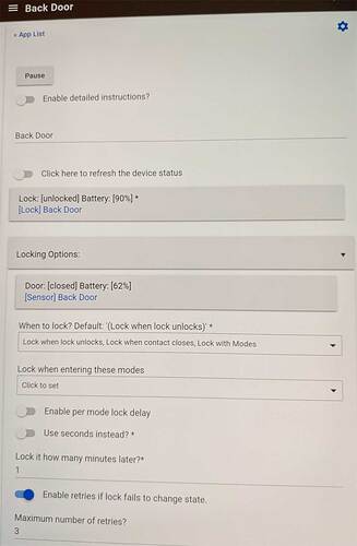

I unchecked lock with modes and am still in the same boat.
I get that same error on same line from time to time seems to still work though.
Funny thing it will show Unlocked but not Locked

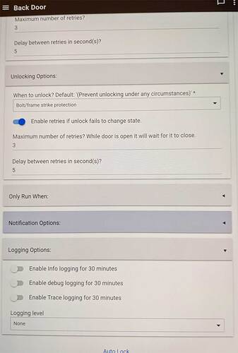

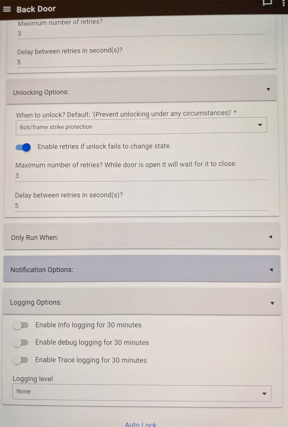

@eric22 Back on topic lets see if I can't track down the retry count issue... Could you post a screenshot of the logs including the events before and after that error with debug logging enabled?
ok will do... get back with it tomorrow.
