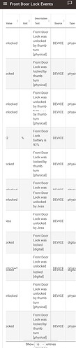

O wow that is cool!
Can you send me the lock events? The format of the text is probably different than what is currently captured.

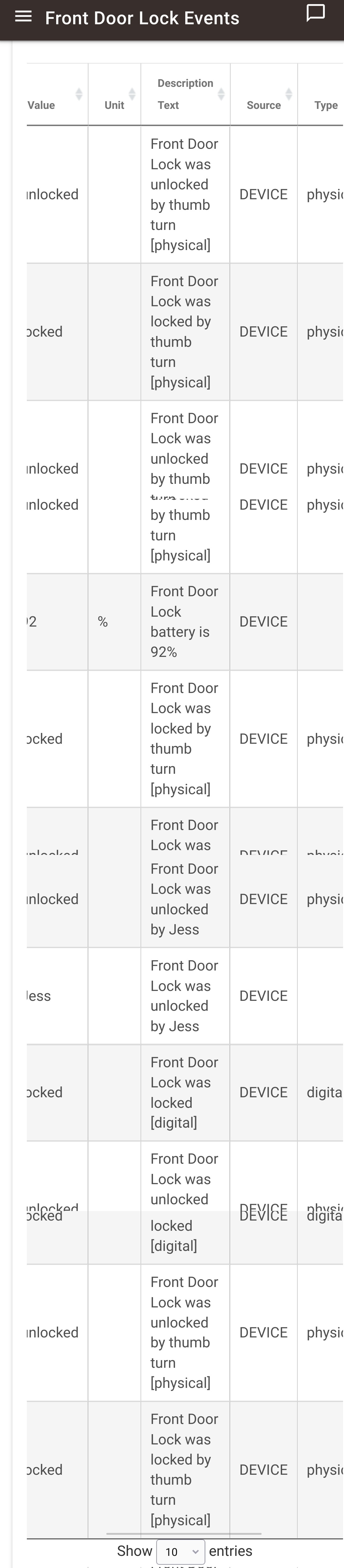

You mean from the events page like this screenshot?
I wanted to copy and paste on the computer for you but I can't login to the forum from my PC today for some reason.
Sorry for the potato formatting.

Working on adding the device events.
} else if (evt.type == 'physical' && evt.descriptionText.endsWith('locked by thumb turn') && (notifyOnEvent == true) && eventNotificationDevices && settings.eventNotifications?.contains("1")) {sendEventNotification("Locked manually")}
1.1.35 released. Added additional locking and unlocking events.
1.1.36 released. I reworked event notifications to better handle all locks since drivers can format the event text differently depending on the manufacturer. You'll need to re-enable any notification options though.

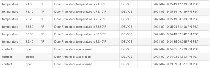

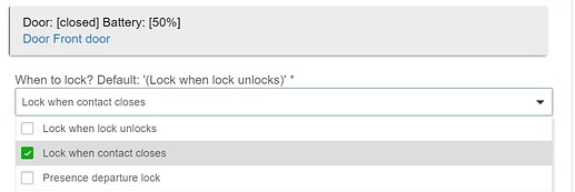

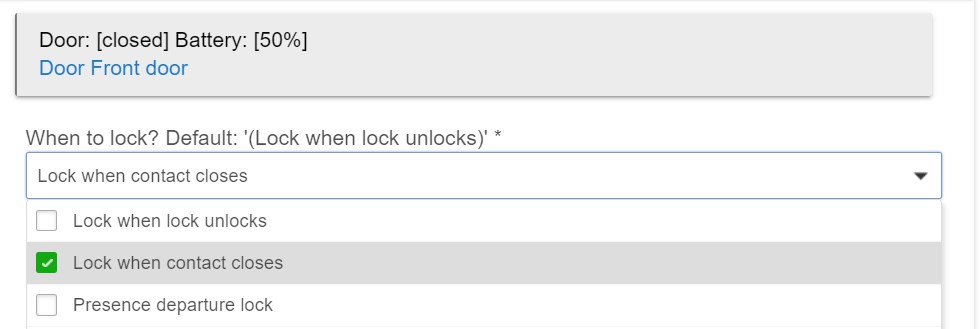

I had a couple incidents of my front door locking when it was open. Info below from one instance. I only have "Lock when contact closes" enabled.

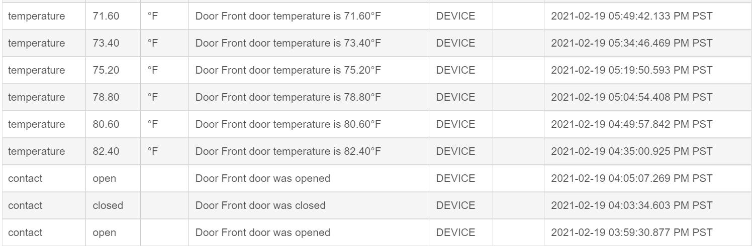

Door events showing opened at 4:05 and still open at 4:13 when Auto Lock locked it.
Lemme take a look.

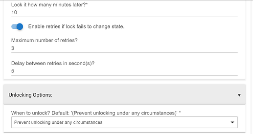

Lock was scheduled to lock 10 minutes after the door closed event at 4:03. Added an unschedule to the contact open event handler to clear the scheduled event. Added some unschedules in other functions as well. I'll do some internal testing and post the code to hpm and github tomorrow.
