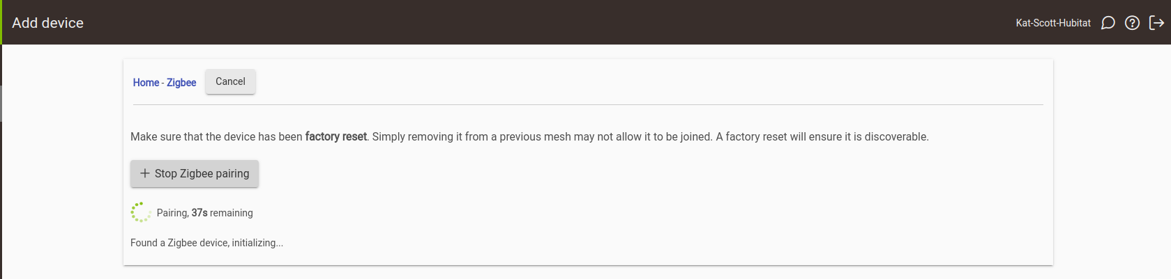

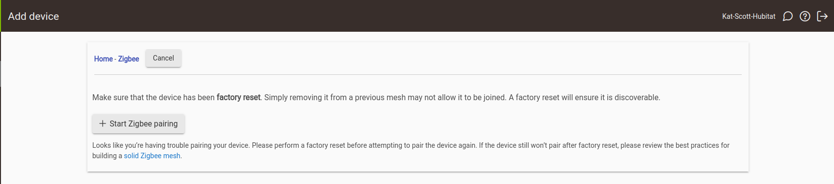

You aren't kidding about not being easy. I am on the 23rd try and I never get past this:
Eventually it fails with this:
I am pairing the device no more than 4 inches from my C7.
By the way, is the blue light on the FP1E supposed to be flashing blue before I start the pairing operation? That's what I have been doing.
Reboot the C-7 hub before pairing. If it still doesn't work, leave it for tomorrow, I will try to make some more detailed description of how the pairing works.
I always click on the pairing button on the HE web page first, then hold the device button for 5 seconds, until it flashes 3 or 4 times blue.
Ok, so you were absolutely correct about trying several times. After the 25th time, it worked.

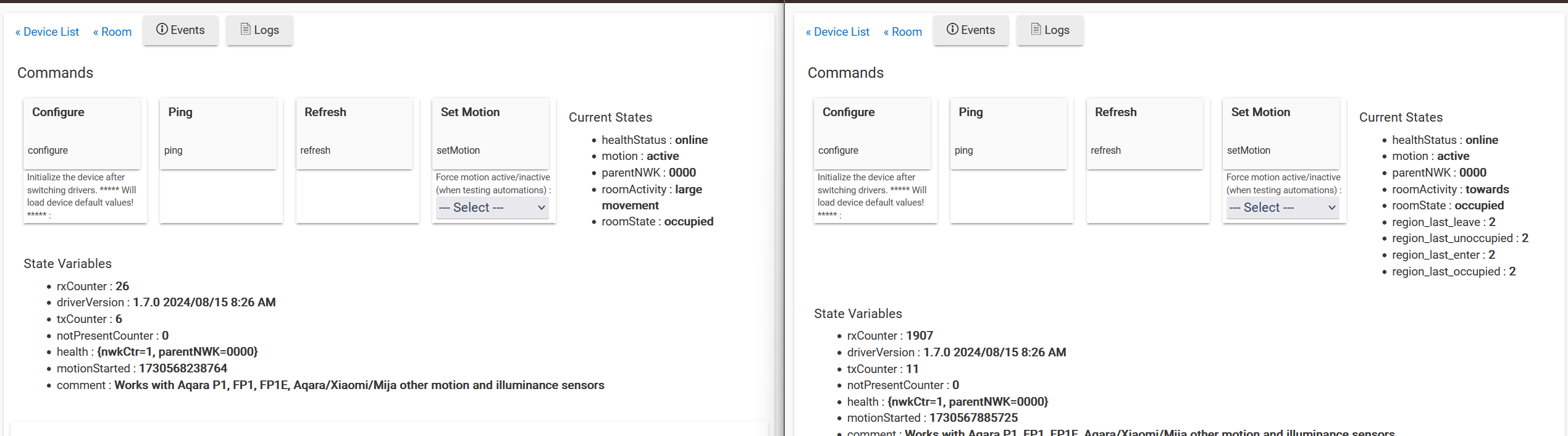

OK, rebooting made it work. maybe I had the 2 mixed up but it seems like the 2 different sensors report different values.
The FP1 was the first one that paired and I was having the issue with the FP1E. The FP1 allows you to set approach distance, motion sensitivity and monitoring mode and the return values of activity tell me if something is approaching.

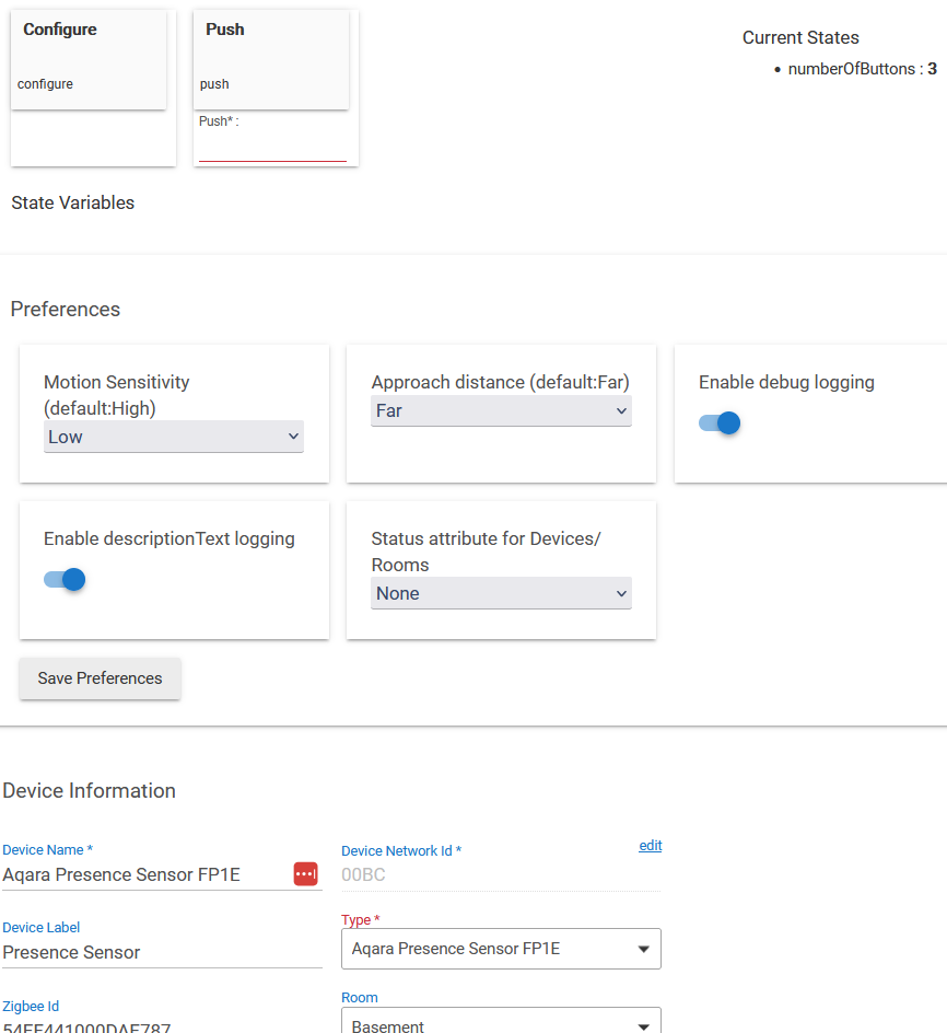

The FP1E does not allow me to set the approach distance, motion sensitivity or the monitoring mode and the roomActivity returns large movement, I haven't seen anything else as it just got installed. IS there a document to tell you what values are supposed to be able to be set, which ones we are supposed to get back as returns? And should these 2 devices report differently like they are.

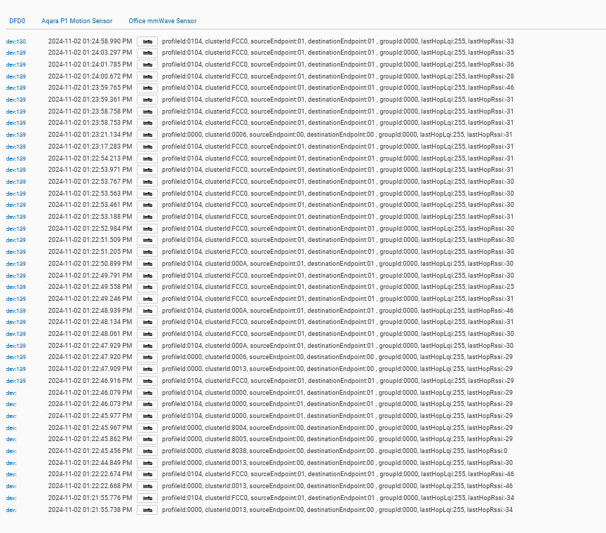

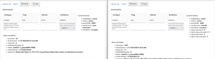

To the question of did the pairing timeout, yes on all instances for both devices. During the pairing process it would say it found a device but if I did not keep it alive it would not install at the end and I would have to repeat the process. And the times it did install correctly it did the exact same thing but if I kept it alive for some amount of time and then held down again and made sure it was alive until the timer ran out then it would install properly. Attached is the logs of install for the FP1 if you wanted to see it

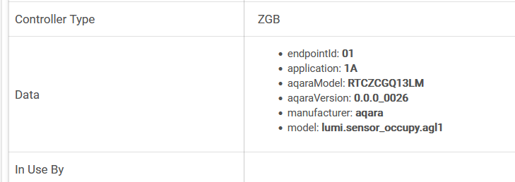

I also attached a device view. I would think that the FP1E would give more data as its a newer device but maybe I am wrong or I still need to install it more than 2 times, maybe it didn't install the second time, I can not be sure
The Aqara FP1E is a different device with different configuration parameters and attributes compared to the old Aqara FP1. Thats why the 'Çurrent States' look differently.
Not all of the FP1E configuration parameters are currently implemented in the custom driver, and I can't say when I will have the time to do it.

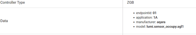

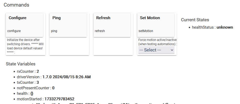

I am having a hard time getting the FP1E to work in HE.
I tried using the built-in HE driver and it does report any motion
I also used the Aquara FP1 Motion Sensor by Kossev and that too does not work what could I be doing wrong?
