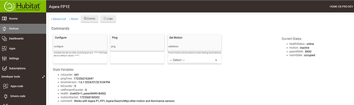

The bad news is that the FP1E is very difficult to pair with C-8 hubs.

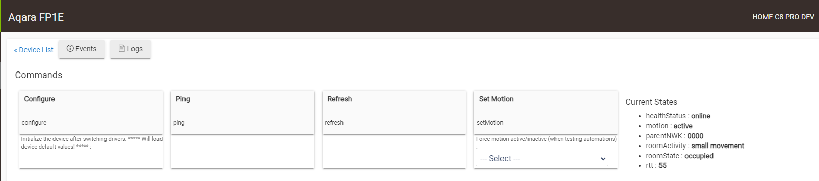

Update: I have now pushed into the dev. branch ver. 1.7.0 time stamp 2024/08/15 8:19 AM :
  • added lumi.sensor_occupy.agl1 - Aqara FP1E;
  • added capability 'Refresh';
  • added spammy reports filtering for FP1E
Only when there is a motion in the room, FP1E sends reports every second... These can not be decoded (yet), so by default they are filtered.
Kinda works ...

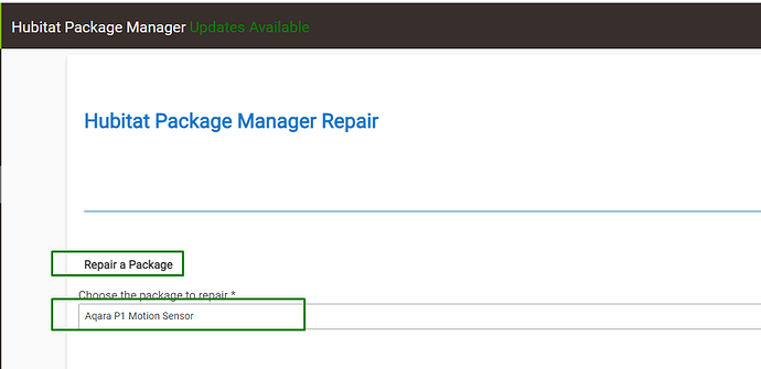

I have also updated the driver main branch to version 1.7.0 .
This update is not pushed via HPM, if you have the FP1E sensor and have the driver installed from HPM, the recommended update method is to use the 'Repair' function :
'Repair' will install the latest Aqara P1 Motion Sensor ver. 1.7.0.
If the driver was installed manually, you can use this method to manually update it.

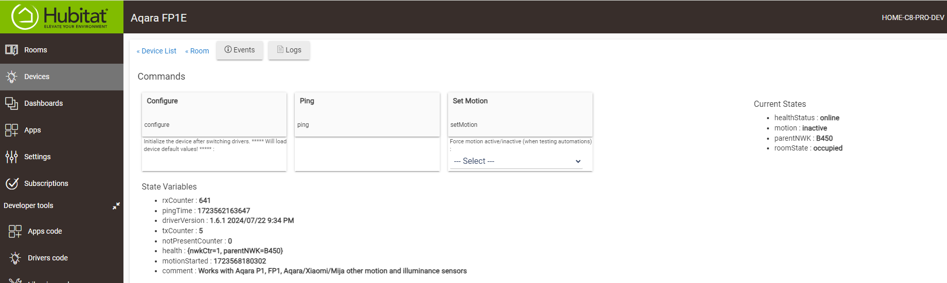

I paired my new FPE1 with the drivers from HPM. The device is paired, but never seems to do anything. Am I missing something. It never sees presence or motion. I have it set to the highest sensitivity and the 10x10 room (small) never sees motion or presence. Am I missing something?
