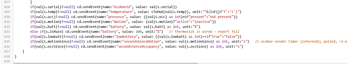

Battery: I'm with you — all-sensors-at-100% is suspect, and I don't fully trust what we're getting either. I pulled a dump on my own thermostat and every one of my sensors also reports 100% / not-low, same as yours, so it's consistent across both setups — which makes me think ecobee's battery over HomeKit may just be decorative. I'm going to force the issue: I'll drop a spent battery into one of mine and watch whether the HomeKit battery / low-battery value ever actually moves. If yours does anything when you swap the Kitchen one, I'd love to hear it — let's compare notes.
Thermostat-sensor temperature: My dump also revealed that he thermostat exposes only one temperature over HomeKit — its CurrentTemperature — with no separate individual built-in-sensor channel like each remote sensor has. So the "Thermostat Sensor" child can only show that value, which is the ecobee's controlling temperature. On mine it reads 26.7 while my remotes read 23.5–26.5, so it's clearly not a plain average of everything — it's the controlling temp per whatever sensor participation you've got set. Either way, the app's per-sensor "just the thermostat" number isn't on the HAP interface, so I can't split it out — it's a HAP limitation, not a driver bug. (It'll also match the parent thermostat's temperature, since they're literally the same characteristic — that child mainly exists to surface the thermostat's built-in motion/occupancy separately.)

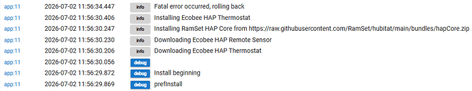

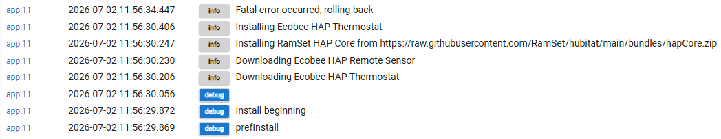

I just tried to install via HPM and it failed:
**Error Occurred During Installation**
An error occurred while installing the package: Failed to install driver https://raw.githubusercontent.com/RamSet/hubitat/main/drivers/ecobee-hap-thermostat/ecobee-hap-thermostat.groovy.
Please notify the package developer..
Be sure the package is not in use with devices.
Right after the failure, I checked and the bundle was installed as was the library. Running the HPM install a second failed the same way, however.
I tried a manual install using the links in the first post. The library went fine (I removed the one HPM added and re-imported it, even though it looked identical). Installing the Thermostat Driver gives this error while doing Save:
The method public int pollSecs() { ... } duplicates another method of the same signature . At [536:1] @ line 536 (library RamSet.hapCore, line 96), column 1.
Looking at the driver and the library, they both contain a pollSecs() methods that are similar but different.
hapCore 0.9.1, ecobee-hap-thermostat.groovy 0.16.2
0.16.3 fixed the error, thank you.

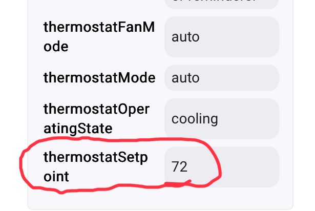

Can you remind me what this is?
It’s technically yhe temperature that the thermostat is shooting for, with one foot note …
  • thermostatSetpoint = HAP TargetTemperature (iid20) — the one temperature the thermostat is actively driving to.
  • Heat mode: that's the heat target (and the driver mirrors it into heatingSetpoint).
  • Cool mode: that's the cool target (mirrored into coolingSetpoint).
  • Auto (dual-setpoint) mode: there is no single target — the ecobee runs between two thresholds, so coolingSetpoint (iid22) and heatingSetpoint (iid23) are the meaningful values. thermostatSetpoint still carries iid20, but it isn't what's driving the system in auto, so don't rely on it there.
So: in heat/cool, yes — thermostatSetpoint is "the temperature it's trying to hit." In auto, use the heating/cooling setpoints instead. If you're writing a rule that should work in any mode, key off the mode first, or use heatingSetpoint/coolingSetpoint rather than thermostatSetpoint.
Ok, nothing has a value of 72° on my thermostat.
I’m in heat/cool auto mode and that number looks a lot like the average of the current cool and heat set points.
So if I switch to cool (only), what is the controlling temperature?
I assume I could ignore this value totally.
in auto, HomeKit only exposes a single TargetTemperature (iid20), and the ecobee fills it with the midpoint of the two thresholds — so 72 = (cool + heat)/2, a number that appears nowhere on the thermostat. That's exactly why thermostatSetpoint is junk in auto.
I updated it where it follow the active threshold — cooling → coolingSetpoint, heating → heatingSetpoint — so it always shows the temp actually being regulated instead of the midpoint.
One edge case is when the system is idle in auto — neither heating nor cooling — so there's no single active target. There it falls back to whichever threshold is nearest the current temperature (the one it'll defend next). I also added a setpointDetail attribute that spells out what thermostatSetpoint is reflecting at any moment — heating setpoint, cooling setpoint, cooling setpoint (auto), auto — nearest target (idle), off — so the number's never ambiguous. Heat-only and cool-only are unchanged; it was already the single target there. It's in 0.17.0.

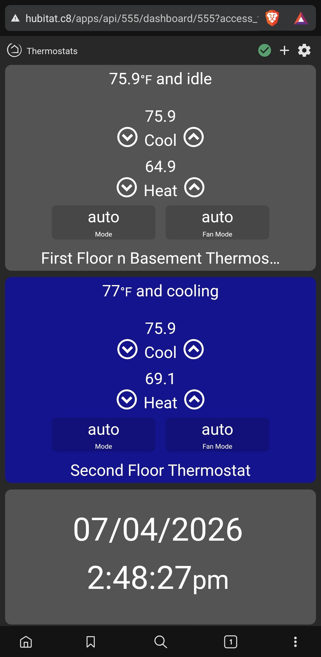

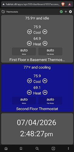

I'm getting temperatures to nearest 10th of a degree now including set point which is weird. Arrows change setup points by 1 degree still so not sure how to ever get rid of .9 or .1 in set point.
