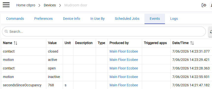

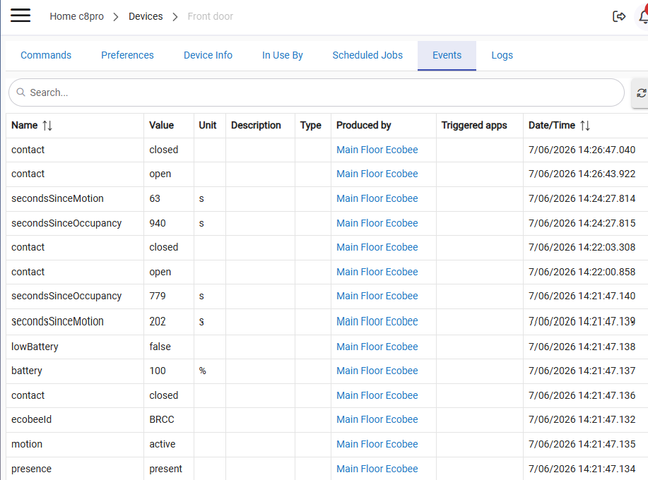

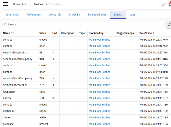

And it works perfectly! Open/close events line up correctly.

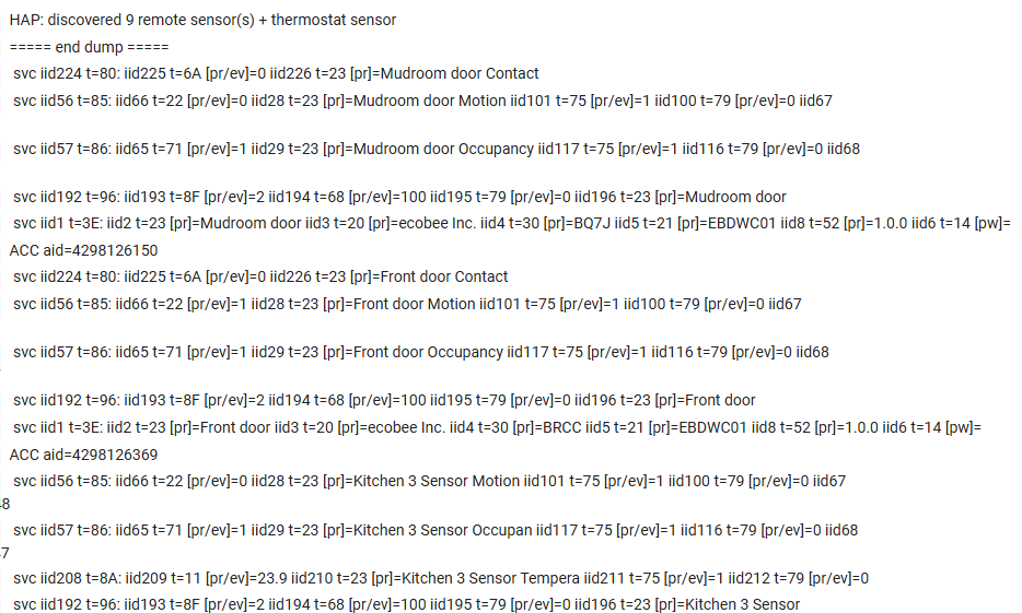

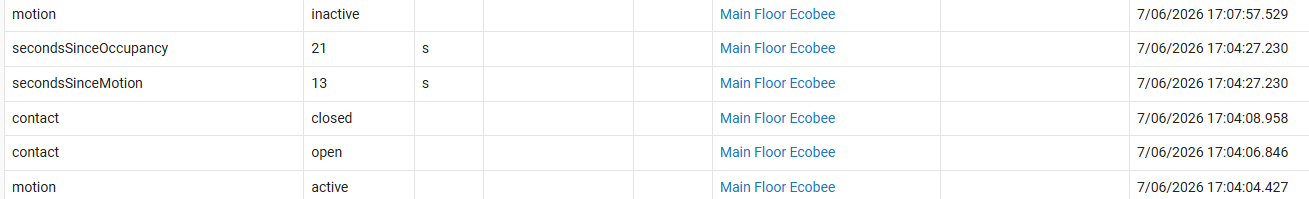

Something interesting on the other contact (Front door). It hasn't reported motion: inactive yet, since it was first detected.
Let one of the motion sensors settle for a few minutes then send me the output of Dump Accessories from the Logs …
Make sure Debug Logging is enabled before that.
Sending it now in a PM.

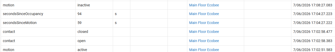

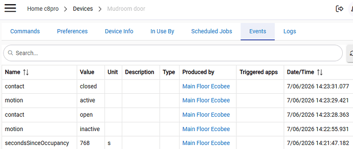

I'm seeing variable timing on when inactive fires, anywhere from 3 minutes to 15 minutes. These devices are in fairly active areas of the house, but I just checked the timing when no one was around.
I've never really looked at how long this took on them before. I suspect they might just not have a reliable timeout (unlike the temp sensors).
These logs are from when I know I was the only motion.
Front door (5m36s)
Mudroom door (3m53s)
That lines up with the dump: the ecobee holds the right value but doesn't reliably push the motion-clear as an event — so "inactive" arrives either whenever it does push it or on the driver's next background read, which is why the delay varies instead of being a fixed period. Part device (its own motion timeout isn't consistent), part that the clear rides the poll.
The long first time was just the initial subscription settling.
I dug into what the sensors expose, and the honest answer is the variability is the ecobee's own design, not something the driver can smooth out automatically.
On these door units, motion is slow occupancy-style detection (minutes-scale), not a snappy PIR — and "inactive" fires on the ecobee's internal timeout, which is what you're seeing swing from ~3 to 15 minutes.
There's no steadier signal to switch to. Both MotionDetected and the secondsSinceMotion counter run off that same variable timeout, and secondsSinceMotion only updates on the background poll anyway — so I can't derive a more consistent "inactive" from the device; it just doesn't expose one. The driver currently reflects whatever the ecobee reports, which is accurate but inherits the jitter.
