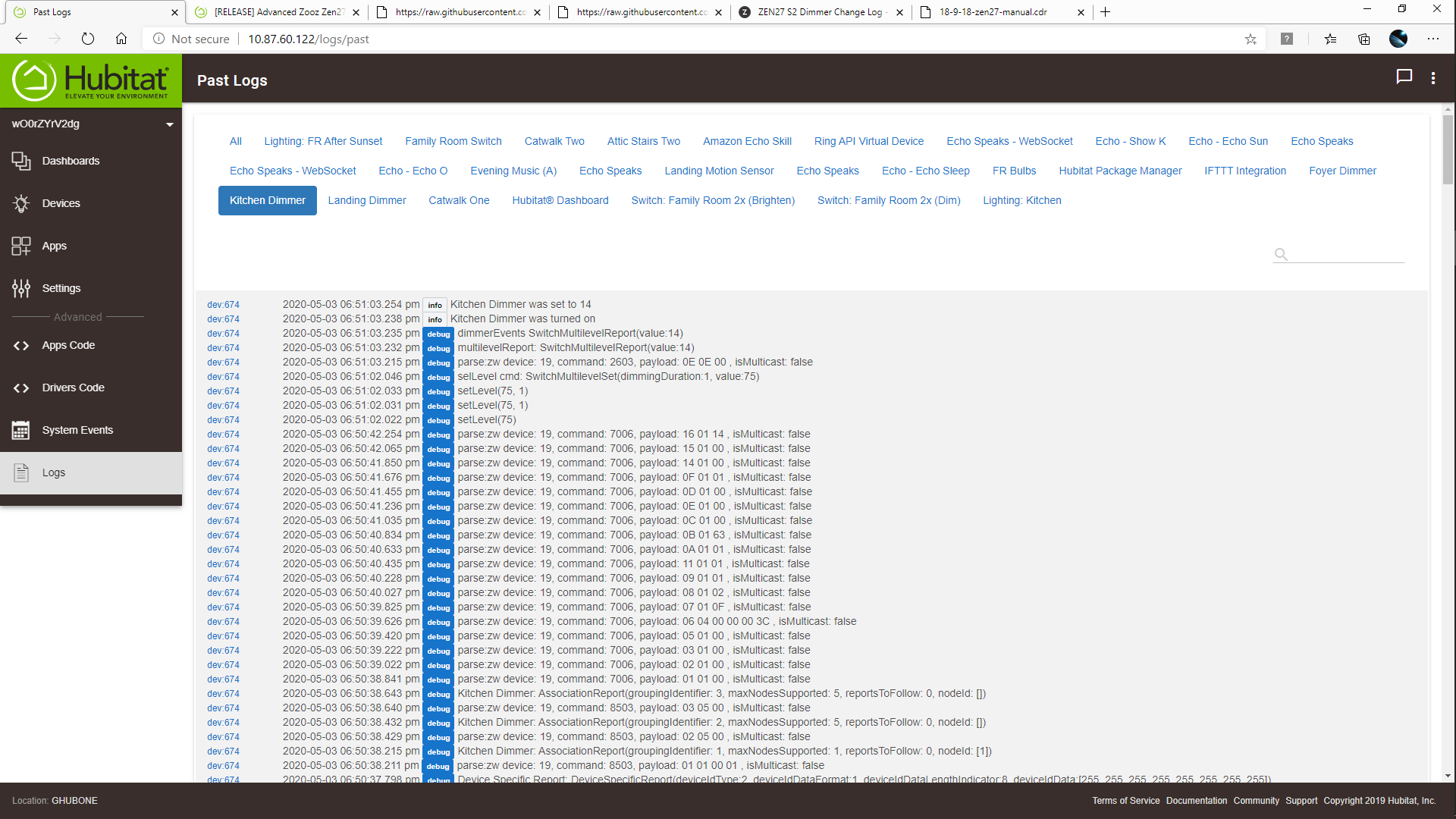

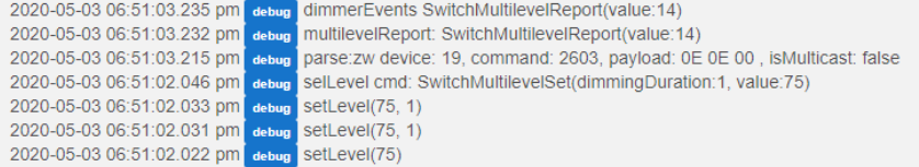

Analyzing
Ok.. so clearly we are sending level 75 duration 1
Then we get back a 2603 (switchMultiLevelReport)
| Hex | Dec | |
| Current Value | 0E | 14 |
| Target Value | 0E | 14 |
| Duration | 00 | 0 |
Ok .. This makes no sense ..
We sent out multilevelSet 75
and got a report of 14 with a target of 14 and duration of 0 so nothing delayed ..
I don't see anything in the device config that should be causing this either..
