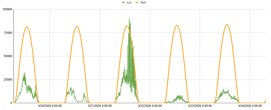

Sounds interesting I have 7 years of solar / lux readings from my station so far collected and I agree cloudy detection has been the hardest. Just take a look at yesterday's partly cloudy day. I can see the dips in lux which means a clouds rolled over my property. But when I run the 5 years of data though AI for insights for detecting clouds Claude.ai was not able to come up with a good pattern to detect them.
Basically, I just calculate the sunny lux curve, and compare current lux to it. That had its own issues, as the difference % is also not consistent, which was the biggest struggle with writing my driver and scaling values based on altitude. This is the last week of my generated lux (orange) and actual lux chart.
Sensors get a bit wonky around noon, as they get a bit less accurate due to light scattering and the cosine correction they use.

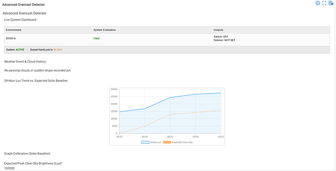

I’ve massively upgraded the environmental monitoring capabilities of the app, transitioning it from a simple lux-triggered automator into a predictive micro-weather station. Here is what is new:
  • 24-Hour Lux Trend Graphing: The dashboard now features a live, visual line graph charting your local illuminance over the last 24 hours. The app intelligently samples and stores data points every 15 minutes to keep hub memory usage highly optimized without sacrificing visibility.
  • Smart Dip & Weather Event Detection: The app no longer just looks at static thresholds; it calculates the Rate of Change. It can now successfully differentiate between the natural, gradual fade of an afternoon sunset and the sudden, sharp lux plunge of an incoming storm or heavy cloud cover.
  • Weather Event & Cloud History Table: A dedicated UI table now meticulously logs every micro-weather event. It tracks the exact start time, the total duration of the cloud cover (down to the second), the total lux drop experienced, and the lowest lux point reached during the event.
  • Expected Solar Baseline Tracking: The 24-hour graph now plots a dual-line chart. It calculates a theoretical "perfect clear day" solar curve (based on your hub's daily sunrise and sunset times) and overlays your actual sensor readings on top of it. This makes it instantly obvious if you are having a generally overcast day or a clear day with intermittent clouds.
  • Custom Sensor Calibration: Because every sensor is placed differently (direct sun vs. shaded under an eave), I added a calibration setting for "Expected Peak Clear-Sky Brightness" to perfectly scale the theoretical solar curve to match your specific hardware setup.

  • 24-Hour Solar Baseline Graphing: The live dashboard now includes a dynamic line chart (via QuickChart.io) that plots your actual 24-hour lux trend against a theoretical "Expected Clear Sky" baseline. You can calibrate this by setting your sensor's peak solar noon lux.
  • Intelligent Cloud & Weather Event History: The app now analyzes how fast the light drops. If it detects a plunge of 30% or >15,000 lux rapidly, it tracks it as an active weather event rather than a gradual evening fade. It logs the event duration, the total lux drop, and the lowest point reached to a dedicated history table.
