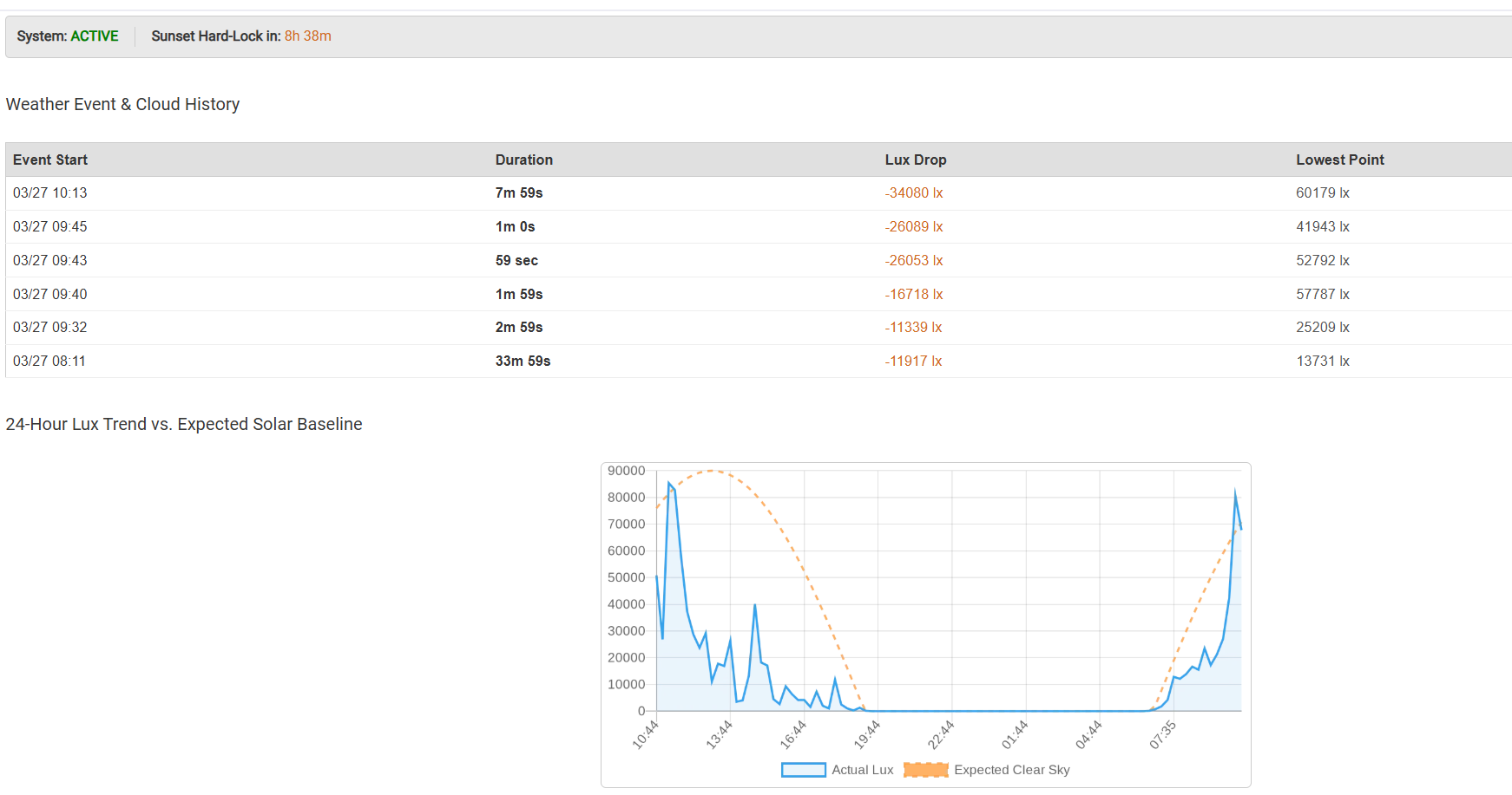

That is exactly why I wrote the SunCalc Illuminace Driver. Lots of calculations are needed. I calculate Irradiance from sun altitude and azimuth (what the original SunCalc driver provides) and I derive lux from that. My write-up in that post explains all the issues I encountered with getting a working % lux report for any time of day, allowing me to know the current sky condition and a more general sky condition, using the % of sunny lux value.
Since it is based on sun altitude and azimuth, the sunny lux generated curve changes every day automatically through the year.
  • Fixed the "Expected Clear Sky" Graph Flatline: Previously, if you had the Dynamic Clear threshold enabled, the graph would plot the internal logic limit (which caps around 4,000 lux) instead of the actual theoretical solar curve. This caused the baseline to look like a flat line at the bottom of a 100k lux chart. The graph now always plots the beautiful, mathematically correct solar sine wave for your visual reference, while keeping the internal limits separate.
  • All-New "Peak Tracker" for Weather Events: The old logic calculated sudden lux drops by comparing the current reading to the immediate previous reading. The flaw? A massive storm doesn't drop from 85k to 30k in a single millisecond; it sends multiple updates on the way down. Because the baseline reset on every ping, the app was blind to the massive overall drop. The app now utilizes a Peak Tracker that holds the highest recent lux value and measures the total drop over a rolling time window. (You'll also notice the logging terminology has been updated to track these as "Potential Clouding" events).
  • Dynamic, Hardware-Scaled Timers: This is the biggest functional change. A hardcoded 20-minute rapid-drop window completely breaks if your sensor only reports every 15 minutes (you might miss the bottom of the drop entirely between pings!). There is a new "Sensor Update Interval" preference. You now tell the app exactly how often your specific sensor reports, and the app will dynamically scale its timeout windows and math to ensure it spans across at least two full update cycles. No more missed storms due to lazy Zigbee/Z-Wave reporting limits!

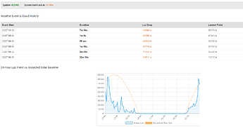

Looking good so far:

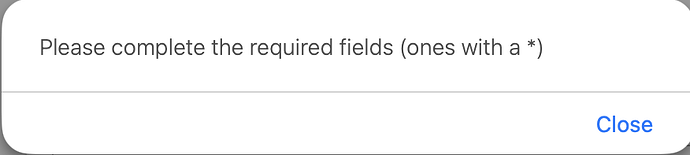

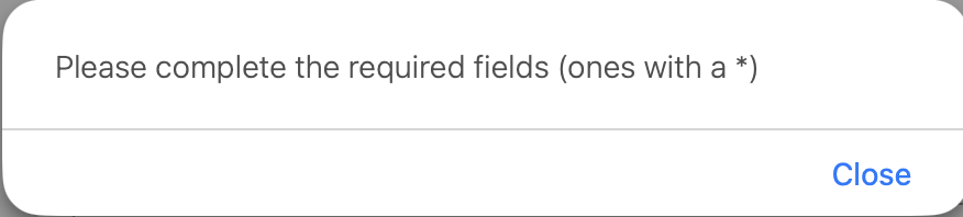

Updated to the latest version. When I tried to make any changes to the option and hit Done, I get this message:
All of the fields are filled in. I tried changing them, but no dice. I can't make any changes.
C-8 Pro on 2.4.4.155. MacBook and Safari. Same problem in Chrome.
Ill remove the required fields and see if that helps.
I pushed an update to the GitHub. Let me know if that fixes the issue for you.
That did the trick. Thanks.

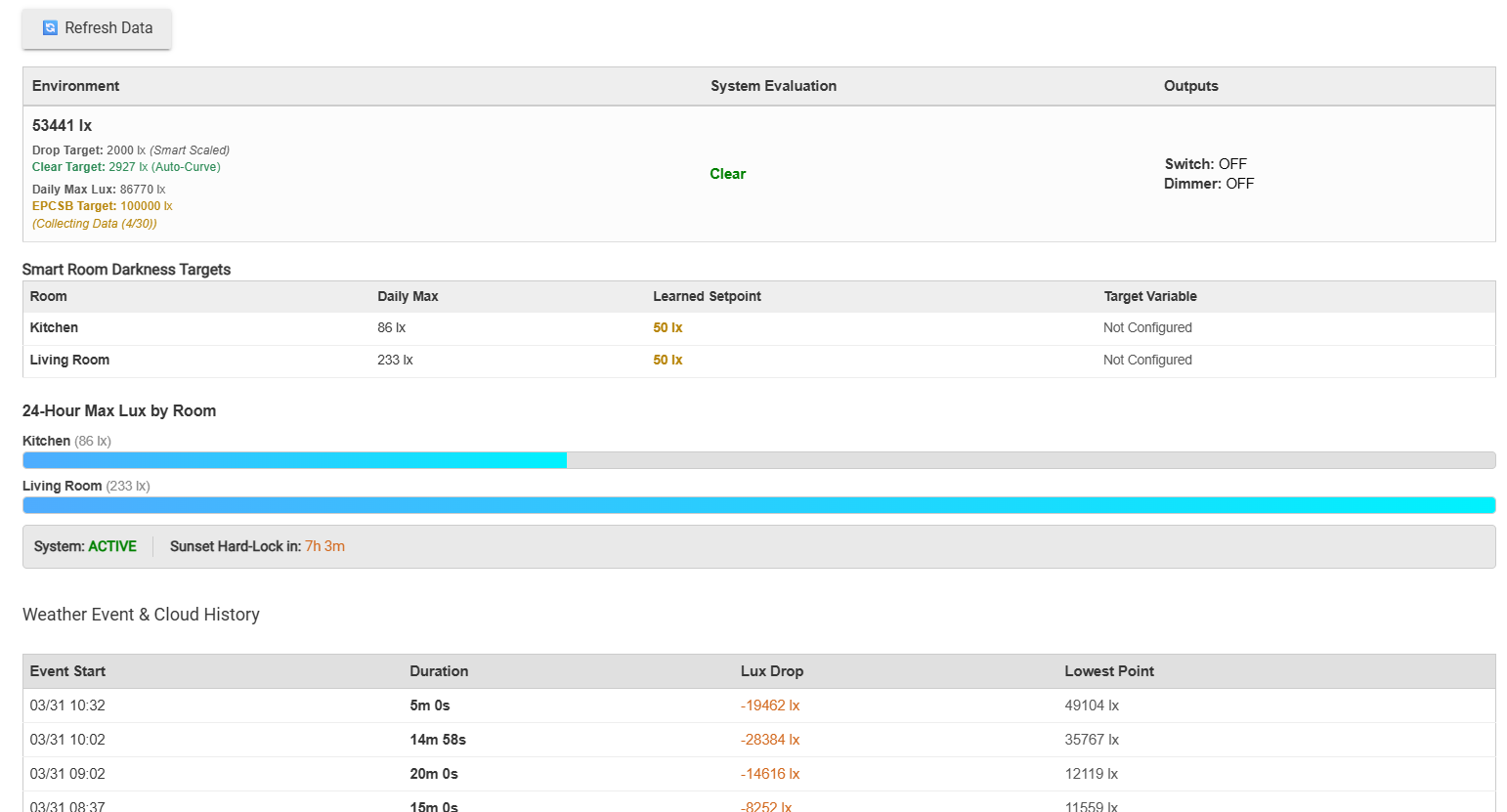

:house: Smart Room 24-Hour Max Lux Dashboard For those of you using the Smart Room Darkness Detection to calculate dynamic indoor setpoints, the Live System Dashboard just got an upgrade.
  • Dynamic Bar Graph: You’ll now see a horizontal bar graph at the bottom of the dashboard tracking the 24-hour maximum lux for each configured room.
  • At-a-Glance Verification: This makes it incredibly easy to see which rooms are getting the most natural light relative to each other, and helps you verify that your "Learned Setpoints" are aligning with reality.

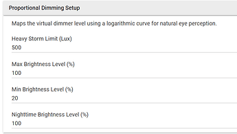

So far so good with this last update. I have now expanded the number of interior lux sensors to all 5 of them this morning. Lets see how that works. Just a question on this section of the configuration I haven't worked with yet.
I assume "heavy storm" is lux of the outdoor sensor when we have a storm move through.
The others I assume it's for global light dimming if I use the app to control lighting directly in the app?
I have been plotting the mmWave Blue Inovelli switches for about a month now with the lux values and they seem accurate:
This is correct. I just received my other 4 indoor lux sensors; the algorithm will start tuning itself after it gets its full 30 days or data. I might make this adjustable for a quicker smart output, but 30 days gives the application a more accurate baseline.

:bar_chart: "Days Learned" Dashboard Tracking It is no longer a guessing game as to when your smart rooms will switch from your manual fallback settings to the dynamic algorithm. I’ve injected a new Days Learned column directly into the Live System Dashboard's Smart Room table.
  • It dynamically color-codes your progress. You will see an orange "Learning" status while it gathers data, which will flip to a green "Active" status the moment it hits your required threshold and takes over the math.
