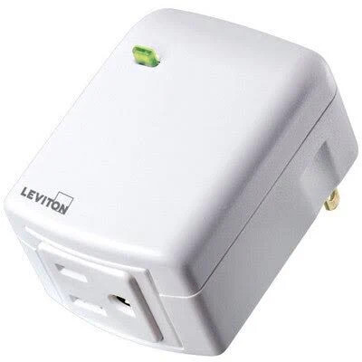

I often just use a plug in switch as a repeater like the one below.

This would be the thing to try with the switch you have been trying to use. It might even take multiple repeaters, but one in a strategic location might be just enough.
