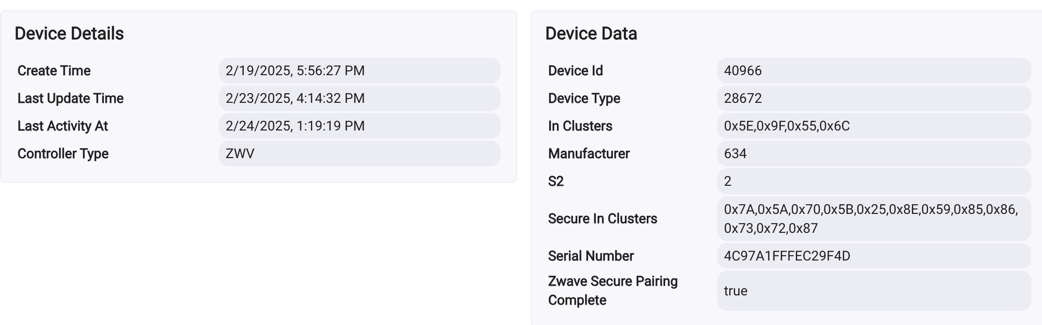

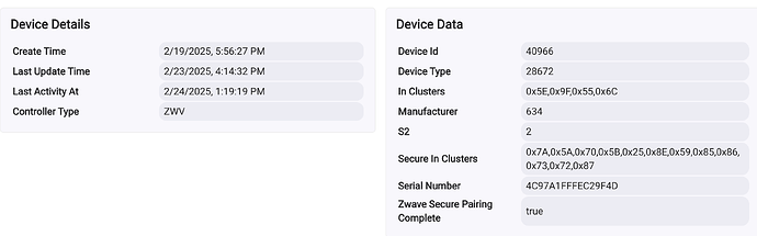

All you have to do is go to the Device Info > Device Details and tell us what firmware it has on it currently.
I don't see firmware details in Device Details...
Guess you need a better driver then :wink:
Or you can use the Firmware Updater app, select the switch and I think hit next, to where it checks and shows you the current version.
