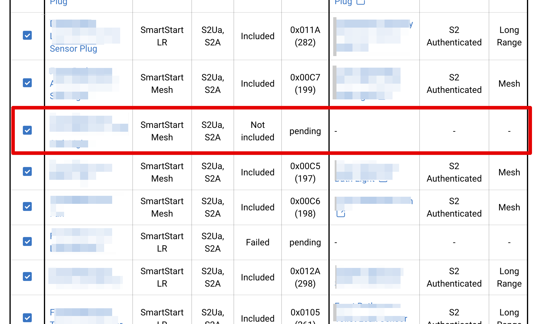

Marginally related, I have one LR device stuck in "Pending/Not Included", and I have no idea what to do. My only thought was cutting its power via the breaker and restarting it, which didn't help. How does one "reconnect" an LR device?

Re: the pending LR device, are you by chance using Jeff's SmartStart Manager app -- if so, is that device's entry disabled? That would prevent an auto-join.

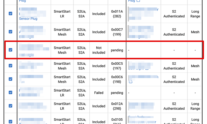

It is enabled according to what I see:

Yep, it's enabled there, so it should auto-join on a power-up.
Is that device showing up anywhere else in any way, shape, or form -- such as on your ZW Settings page or on your Devices page/listing?
If not, you can edit that SS Mgr App listing to remove that entry -- maybe that could give you a do-over... But I'd defer to @jtp10181 on troubleshooting that -- I've been fortunate to not experience any SS pairing issues.
No and no :frowning: Let's wait for the master, I guess :slight_smile:
