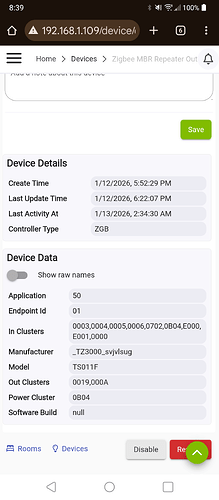

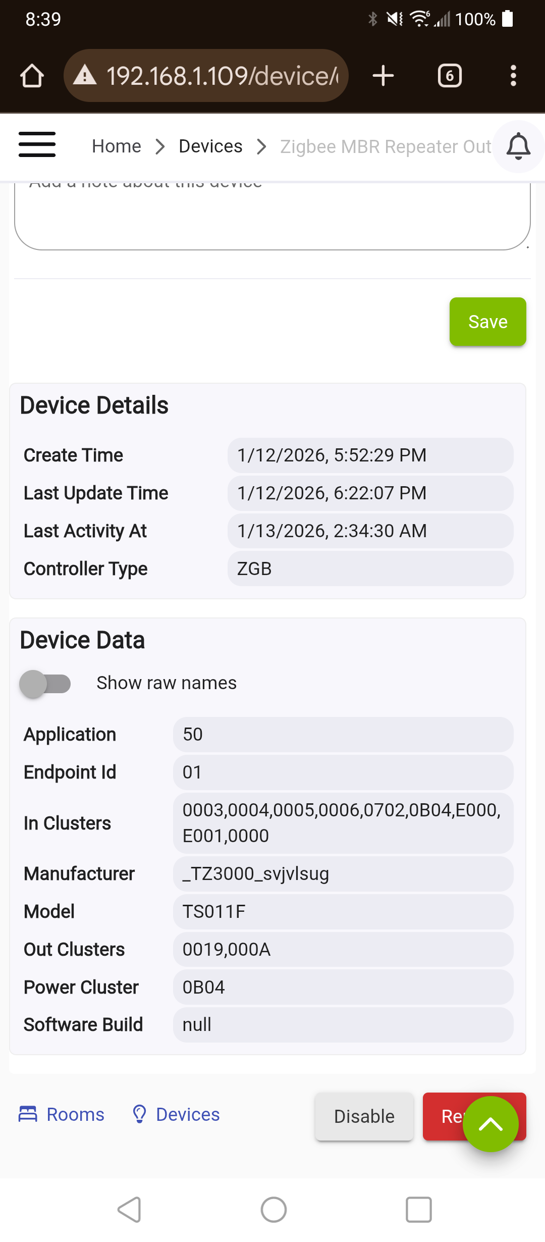

got this working with stock driver but cannot toggle each endpoint separately. it is a std outlet with a USB c and USB a. and power monitoring also not working. as well as led on/off status. would your driver work better
also the bigger problem is I got it mainly as a Zigbee repeater that renters in the condo can NOT unplug and thus render inoperable. but with the zigbee interview app it is showing as an end device not a repeater
Krassmir,
Does this driver support the Moes 4 port Zigbee switch, if not, what do you suggest?
add the following fingerprint to this driver
    fingerprint profileId: '0104', endpointId: '01', inClusters:'0003,0004,0005,0006,0702,0B04,E000,E001,0000', outClusters:'0019,000A', model:'TS011F', manufacturer:'_TZ3000_svjvlsug', deviceJoinName: 'Tuya Zigbee dual outlet wall socket w usb'  // @lgk !
creates 5 children only the main and first two work..
main turns on the one switch of the 2 (only one is smart controlled) and the usb both.
first child turns on only the switch as it should no usb.
second child turns on the usb only not the switch
next 3 children are noops.. i removed them..
no power reporting.. other than that seems to work..
It does show up as a zigbee repeater (the parent)... (blue circle) in the zigbee map app with this driver whereas it did NOT with the general zigbee outlet driver.
Indicator Light control also seems to work.

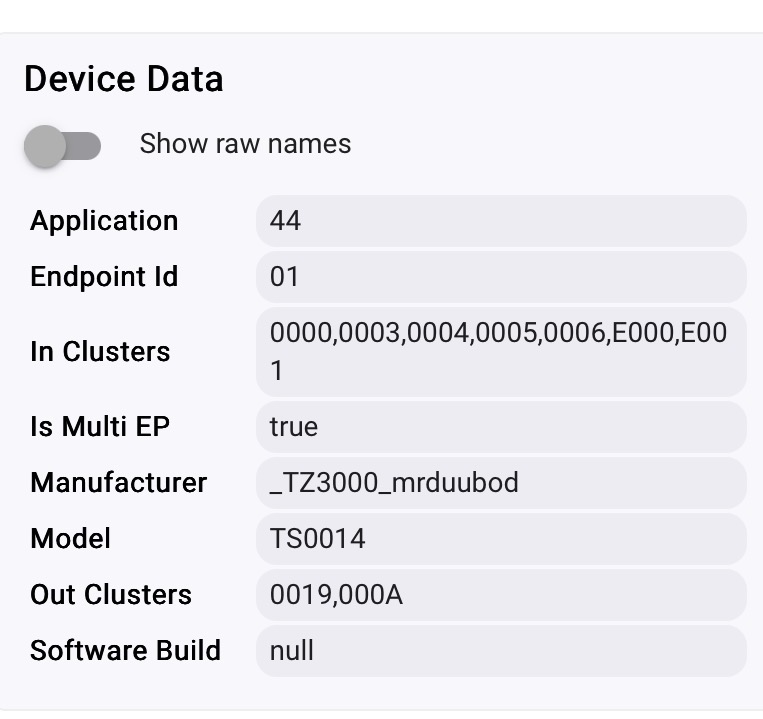

Got an operable sample of the 4 gang and assigned this driver. seem to work ok with the four expected child devices.
fingerprint profileId:"0104", endpointId:"01", inClusters:"0000,0003,0004,0005,0006,E000,E001", outClusters:"0019,000A", model:"TS0014", manufacturer:"_TZ3000_mrduubod", controllerType: "ZGB"
That worked... Thanx!
