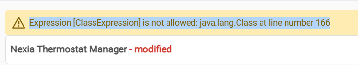

If there is a thermostat device that currently exists, I would delete it before running the app. Make sure to toggle debug logging on before attempting to log in. This will likely still fail... I haven't really changed any code yet; just added more logging.
Looks like there's a class expansion in the code that HE doesn't like. I get this when I try to save the newly imported code.

I merged the fix from Claude into my test branch if you want to try importing it and trying again.
