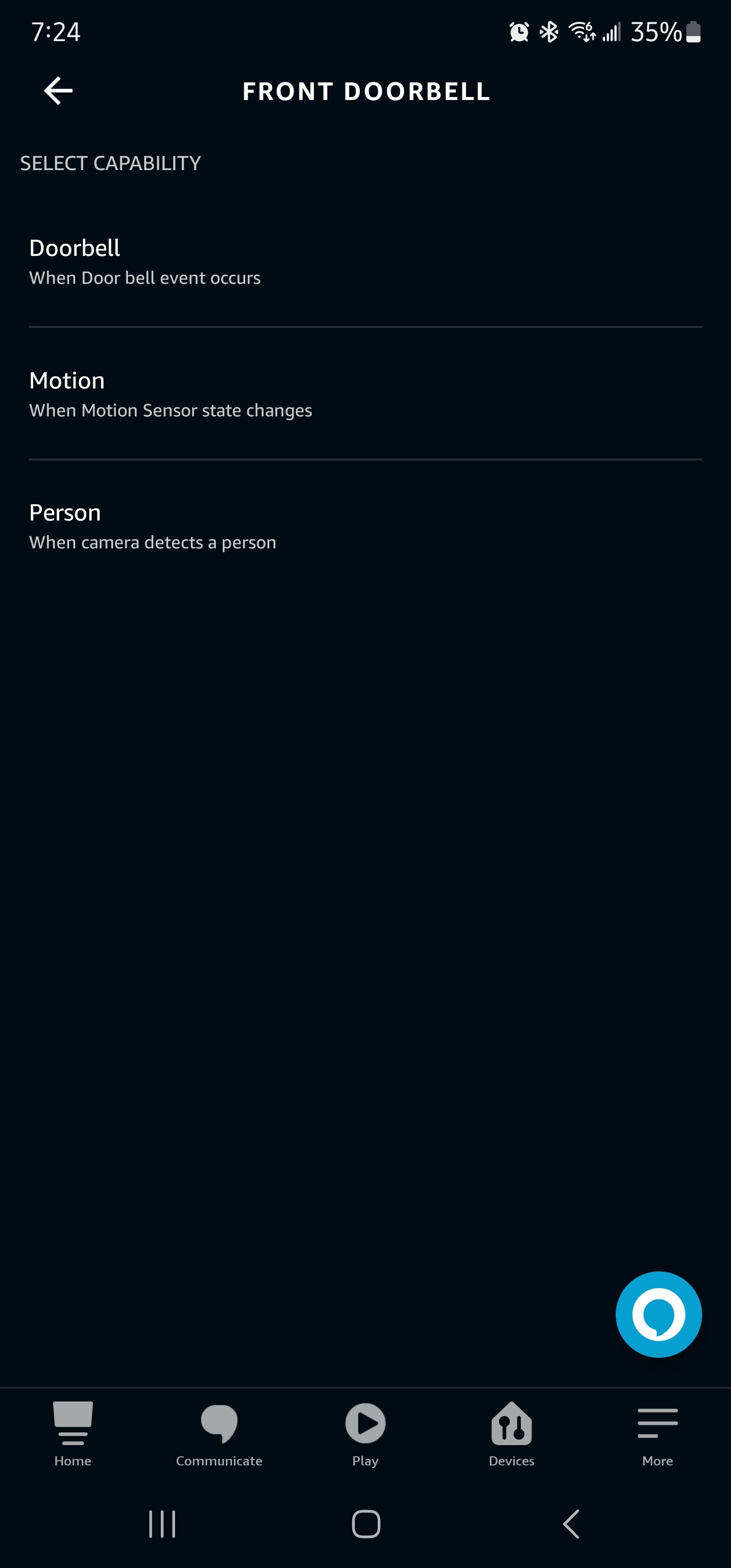

I'd like to make a request. With the newer door bells register a Person/Package Detected as a motion event? They don't send motion events. They send Person or Package detected.
I do. It logs out on its own after 1 or 2 days. Super annoying, i just quit using it.
IFTTT would have to add support for this. They don't currently expose this information
Alexa supports person detection, I use Alexa routines instead of IFTTT. There's a post somewhere on this thread on how to use Alexa instead of IFTTT.
