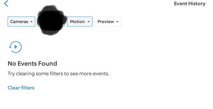

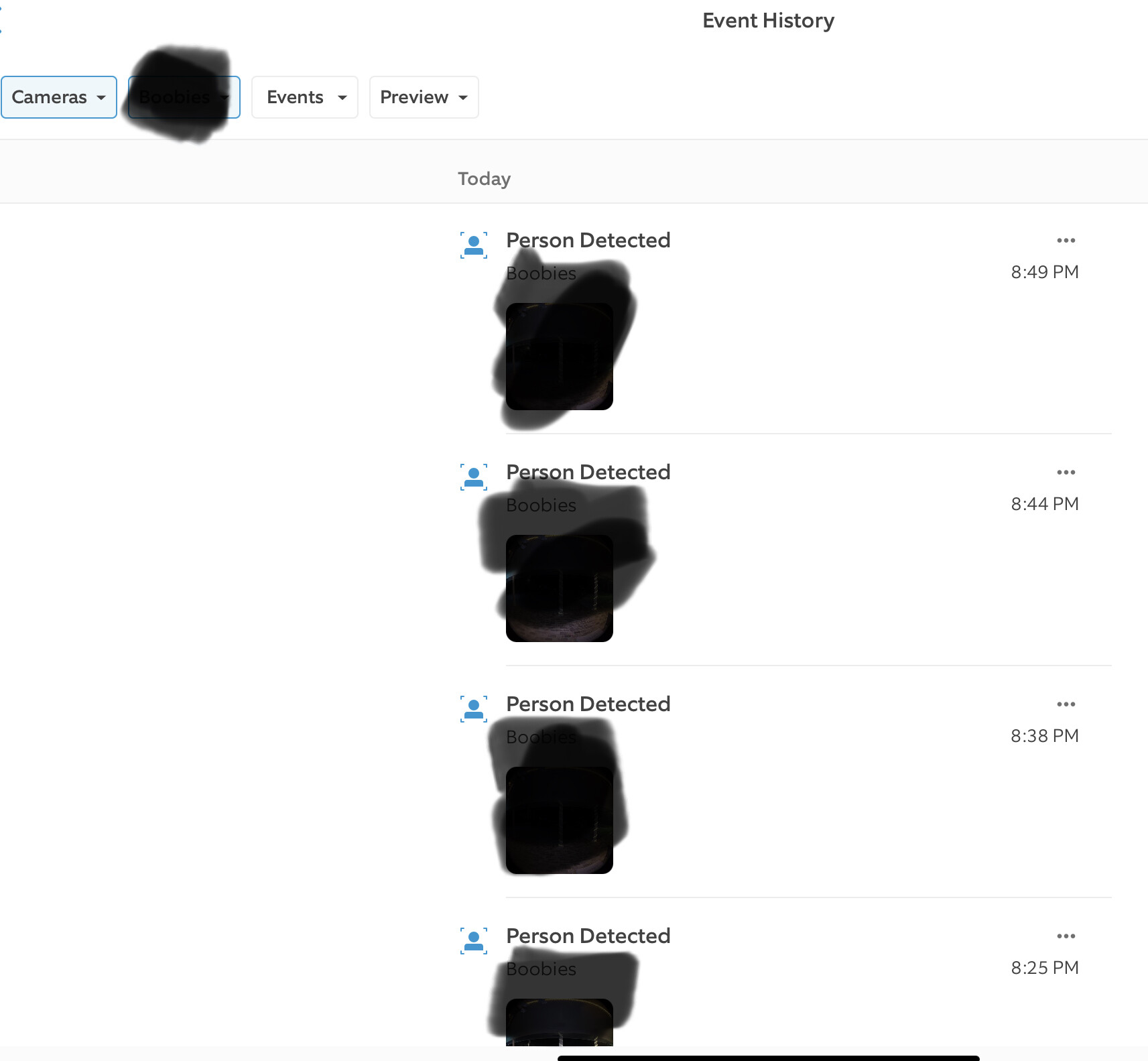

Thanks for the starting point. I did check the Ring app and it has video recordings, however those are all marked as Person Detected. When I filter the history events for motion there are none. Then I checked IFTTT. It hasn’t had any events…likely since I upgraded to this newer doorbell.
It seems with this doorbell maybe Ring is classifying them as people and packages, but not as motion. …or maybe I need to turn off people and package recognization.
I added the screenshots of the event history.

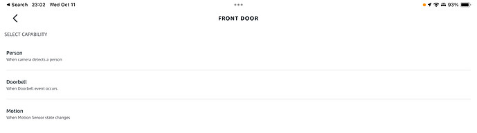

Sounds like that might be the issue. With Alexa, I had to create two rules - one for person events, one for motion:
Thanks. Bummer. I don’t have Alexa and don’t want to add it.
It may also require two rules in IFTTT…
I would set that up, however I can't find a ring trigger in IFTTT for Detect a Person.

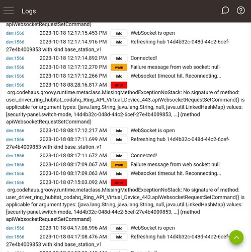

I'm getting some odd information in the logs for my API virtual device, can anyone point me in the right direction to fix it? I'm going away for 2 weeks in a couple of days and want it working properly for the housesitter!

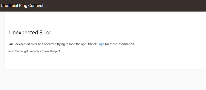

I used HPM. Ive now removed the app and everything from my hub and tried to start again. Now when i discover devices on the app after ive logged in i get this... Any advice?
I'd suggest removing all of the app files, restart your hub then re-add.
Ive just tried that but its still showing the unexpected error on the screenshot above

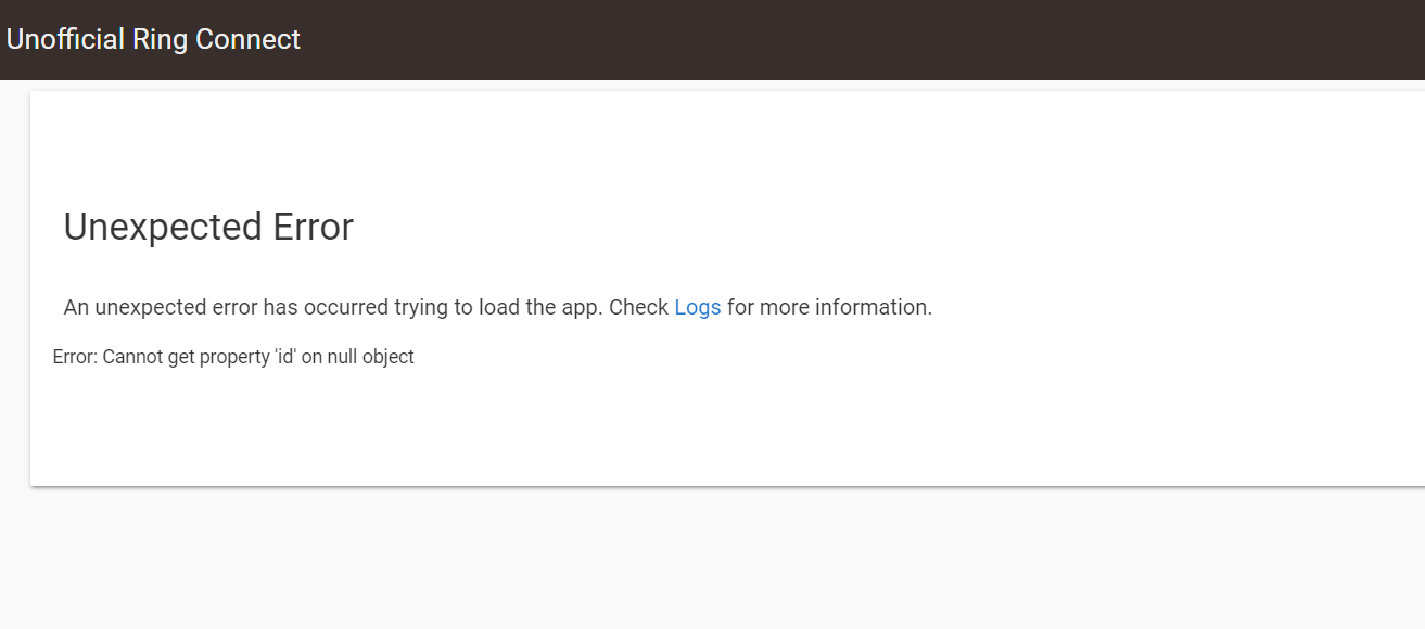

I have the same Error: cannot get property “id” on null object.
Log says “java.lang.NullPointerException: Cannot get property 'id' on null object on line 521 (method addDevices)”.
If I select an individual device, and I tried a few one at a time, the log shows this:
addDevices: Selected id 381222420, Selected device null
The id changes by device but the trace log remains the same.
I’ve removed the app, rebooted the hub and soft reset/restored the hub. When I try to reinstall, the location child object is created and I can see all my Ring cameras and the alarm hub. I select them, click next, and immediately receive the error.
