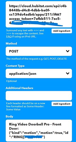

That's good. It means you at least can hit the endpoint, now the question is why can't IFTTT. Are you sure it's setup correctly: Does visiting the full URL from say your phone off your wifi also given the same "Method not allowed" message?
Been using IFTTT for years. Was triggering some Ring events to Smartthings before; transitioning to HE now.
I’ll check the phone.
I seem to be getting the same messages. Can’t copy from the IFTTT app, so I tried the first 2 URLs I notes before.
As long as you are getting the last response, then you are good. Seems like an issue with IFTTT, I'll DM you.
Issue resolved! Thanks @SoundersDude
The issue is that some extraneous info from the app generated URL was pasted into IFTTT. Unfortunately it was on the source line and this was my first time using Webhooks, so it didn’t jump out. After removing the offending details, it worked fine. Note the info ahead of “kind” in the body.

Can you post a screenshot of what you are trying to do (blanking out anything important like I did in that post)?
The only difference between press or motion using the momentary switch is what's in the body.
