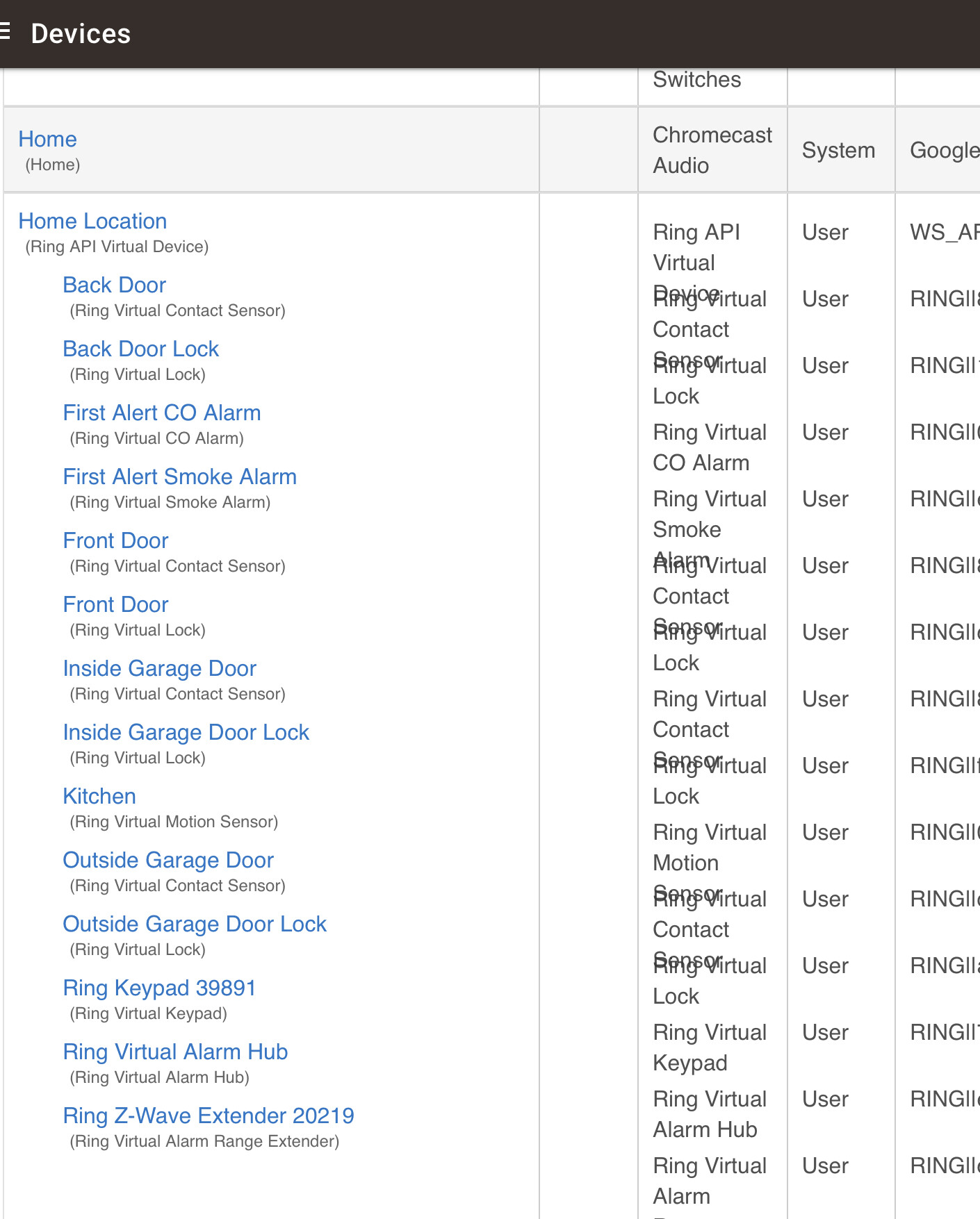

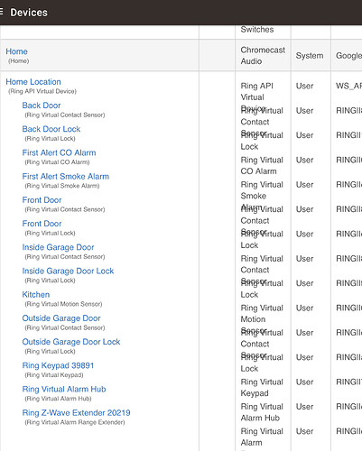

So I am new to hubitat, and I've tried searching here but can't find the right thing to search by.
I've installed this app and the sub-apps using Hubitat Package Manager. I've gone in and logged into my ring account, and my sensors and cameras show up in my devices.
But what doesn't happen is the Ring Connect app never shows up in my apps list.
When I go to add User app, it acts like I've never logged in before and if I try to log in, it causes an error because my Ring controller is already in my devices list.
I do have other apps such as LIFX, Ecobee, and Rachio showing up in the list.
The problem is if I want to change anything in config, or set up a web hook in IFTTT, I can't do any of that. Any ideas? Thanks.

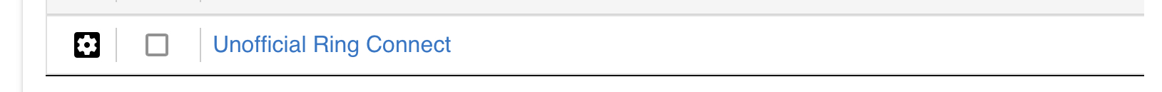

You should see an app called “Unofficial Ring Connect” in your app.
This app also creates devices for your Ring alarm sensors and devices (locks, etc.). Those will be in the device screen under Home location, most likely...

I have the devices, but the app isn't listed. I've tried uninstalling and re-installing and have the same issue.
I tried inserting screenshots but I guess I don't have that permission.
Any ideas appreciated.

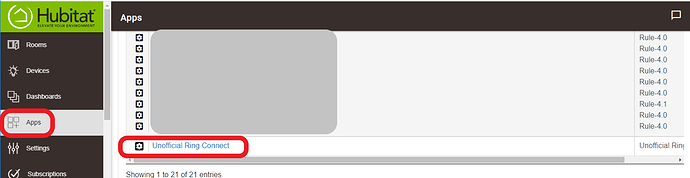

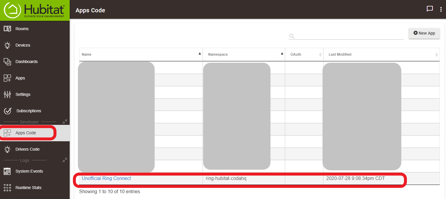

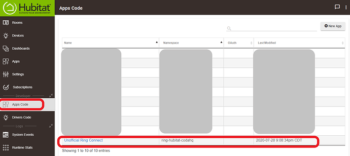

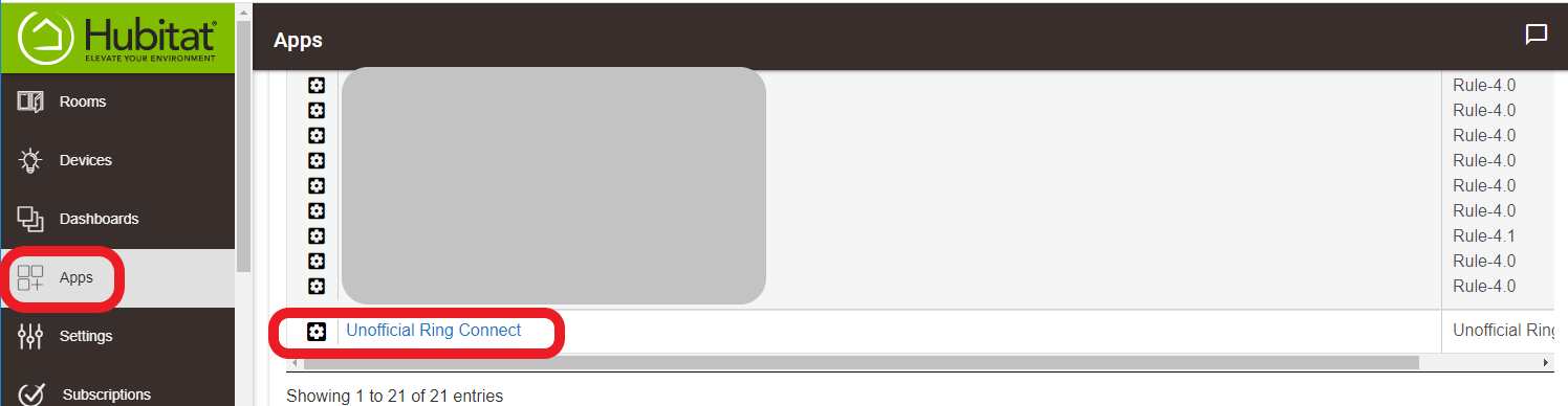

You should see the code installed in the "Apps Code" area:
Then, you should see the app in the "Apps" area:
You'll need to click on "Unofficial Ring Connect" to get to the settings to start the initial configuration.
Hi Rob.
I do have it listed in app code.
Still not showing up in apps.
When I try to go into add local apps, I get an error because I already have the devices installed.
Basically everything works (devices are found) the first time I set it up when adding the local app. But when I go back to apps, it's nowhere to be found.
