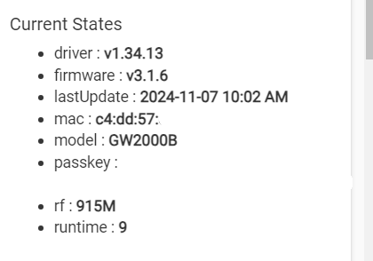

My gw2000 wittboy hub, with the WS90 station and the WH51 sensors stopped working with the update to firmware 3.1.6
Is it possible that this new firmware has stopped being compatible with the hubitat?
Hmmm... That doesn't look good. I hope not.
I don't have a Wittboy or the G2K gateway, so cannot test it myself. Maybe others here with a similar setup can comment on whether they have had the same experience.

No issues with my setup (WS90 & GW2000B)
I don't see anything new on the Ecowitt Forum since 2022.
Has it been moved?
I've often found myself on the WXForum, technically not the official forum....
C-7 running 2.3.9.200
Ecowitt GW2000B_V3.1.6 with 4 temp/humidity ambient sensors
I just performed the upgrade and everything seems to be working.
Maybe your ip changed.
