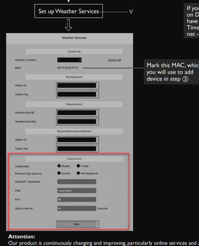

Oh, I should have clarified, you do need to setup the data feel in the EcoWitt App for the sensors to appear in HE.
The pending part that status is that the gateway device in HE needs the regular data feed in order to detect what sensors are paired with the gateway. The IP / MAC are important to make sure the data received by HE is directed to the virtual gateway device on HE, but does not initiate any contact with the physical EcoWitt device, it is all one-way communication from the physical EcoWitt gateway to HE.

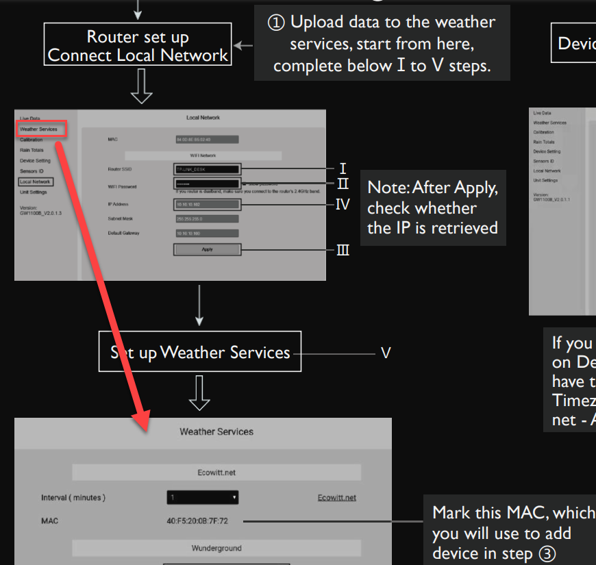

Seems a little harder to find the instructions for setting up the data feed than I thought. Depending on the gateway, there can also be a self-hosted web front-end available, so that could be another option.
EDIT - Looking at the Quick Start Guide, Weather Services seems to be where you need to go and setup the Custom Data Feed:
Finally found these screens in the resident webpage for the hub. Entered data per the pix and then blew out and recreated the Virtual Wifi Gateway on HE. Waiting for some magic. Got these log entries so far:

Yeah, those logs all look fine. I expect the main thing now is to wait for the period of the Upload Interval.
I realized it after posting. It is deleted. Still nothing on the HE side.
Once you have updated the IP / MAC address to one of the values in the log, you will need to wait for the next set of data to come through. You could look at shortening the interval on the gateway to 60 seconds, even just while you are setting it up.
You lost me, I need to update the IP address in HE? I was using the MAC address for the Eco hub.
Post a screen shot of the settings in the ecowitt app as well as the setup screen in the hubitat device if u still are not getting data.
