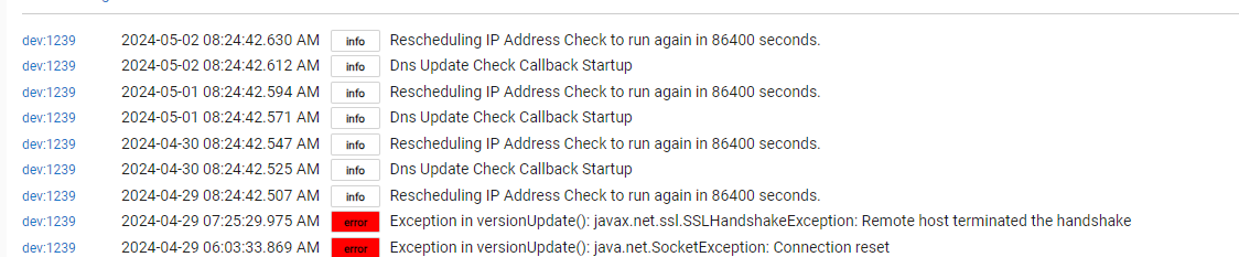

No errors since I turned off the Git Repo.

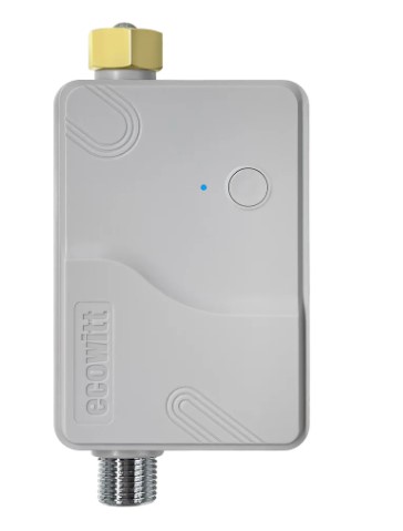

I seen this WFC01 Wittflow Smart Water Timer on their site. Would love to get one but don't know if this can be controlled though Hubitat via this driver?
Screenshot 2024-05-02 084925
It can"t at the moment. It would need some investigating to see what would be involved.
Also note that I believe only certain gateway devices support these, so check if yours does before purchasing one.
OK thanks. Also, their site says the GW2000 can handle 16 of these if I understand it correctly.
Yeah I believe the 2K and the latest matchbox-style GW's can handle them, I think it's the GW1200.
