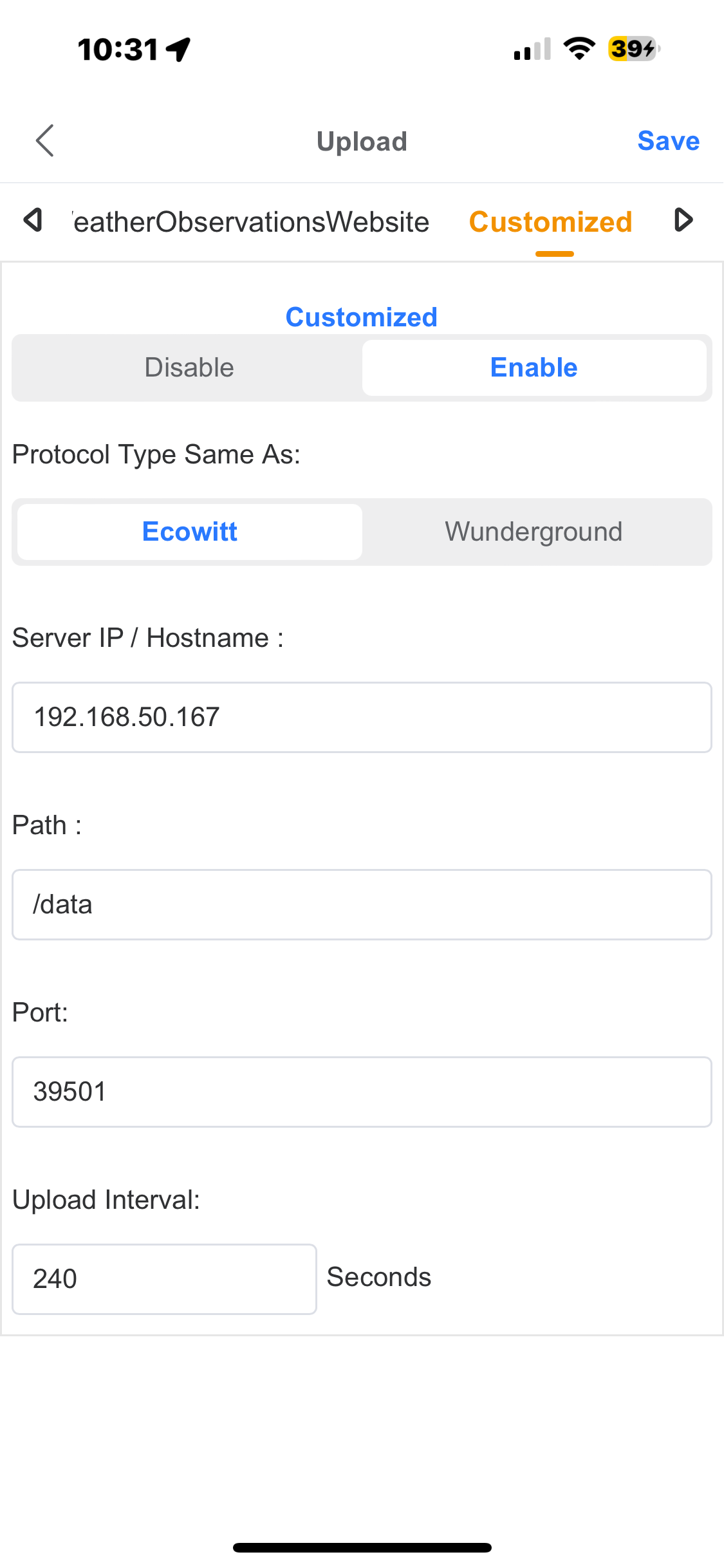

So, my new issue. I did a migration from a C to a C8 last week, My Ecowitt Devices don't seem to have updated since the 13th. I changed the IP Address to the new IP address in WSView. Was there something else I needed to do?

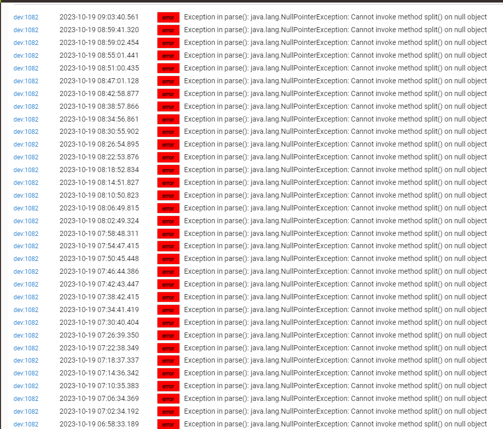

Exception in parse():java.lang.NullPointerException: Cannot invoke method split() on null object
over and over looks like it last got any update was the 13th, which is also the day I did the migration.. I suspect I may have a nuclear event about to happen .

That is odd, I would have expected you to see one or the other, but not both of those. This warning is the symptom of what I was describing earlier, where there is no device with a DNI that matches the source of the data. From your earlier error logs, and this warning, it looks like the errors were occurring and then the warning, in that order....

Save Preferences didn't help. I think some how I got it on one IP as a wired connection, and the new IP is a wireless connection. No idea how that happened, r really been how to fix it, even in the ecowitt app without loosing my data.
