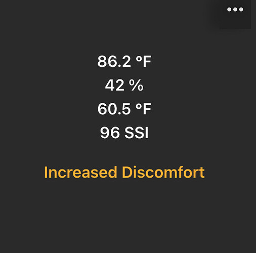

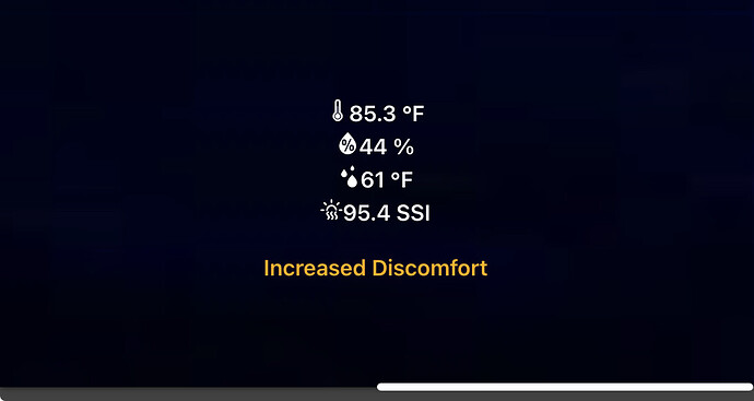

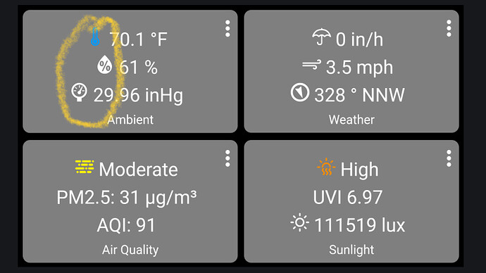

In this instance this is the HTML Tiles I was workin on a few days ago. I finally figured out how to get them to display the Text, but not the icons I mistakenly thought they were supposed to
Supertile wouldn’t work in this case, but I figured out how to make it work in a custom tile
Should that be decreased discomfort now, in that last screenshot :wink: Now that you have figured it out... Nice work btw, getting this going. I should probably make some notes at some point about various options outside of the tile templates feature, i.e. displaying EcoWitt data in other ways or in other platforms like SharpTools.

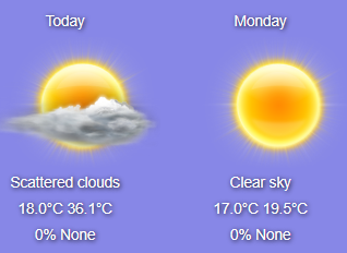

36c on my Wittboy @ the coast but look what tomorrow's high is forecast to be !!

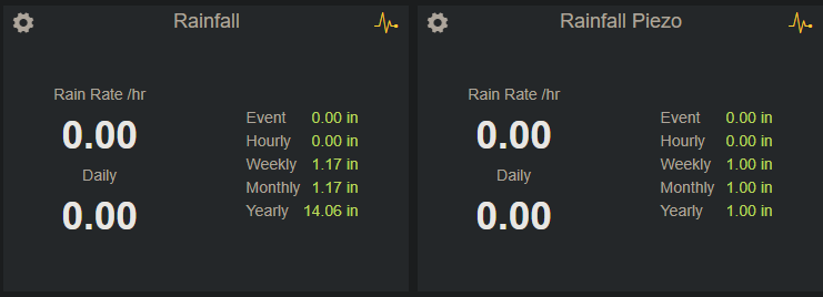

An interesting update on the Wittboy vs traditional sensor, at least as far as rain goes. Within a week of installing the Wittboy, we finally got our first measurable rain in several months. I was under the impression the Wittboy with the piezo-electric rain gauge would be more accurate, but after this rain event, it appears the Wittboy was detecting slightly less, almost 2/10ths of an inch less than the traditional rain cup (yes I left it in the system, and plan to continue to. This actually has me curious enough I may go ahead and pick up the traditional mechanical sensor array just to do a side-by-side comparison to see how far off (or close) to each other they are.
below are the device readings from both devices in the Ecowitt app:

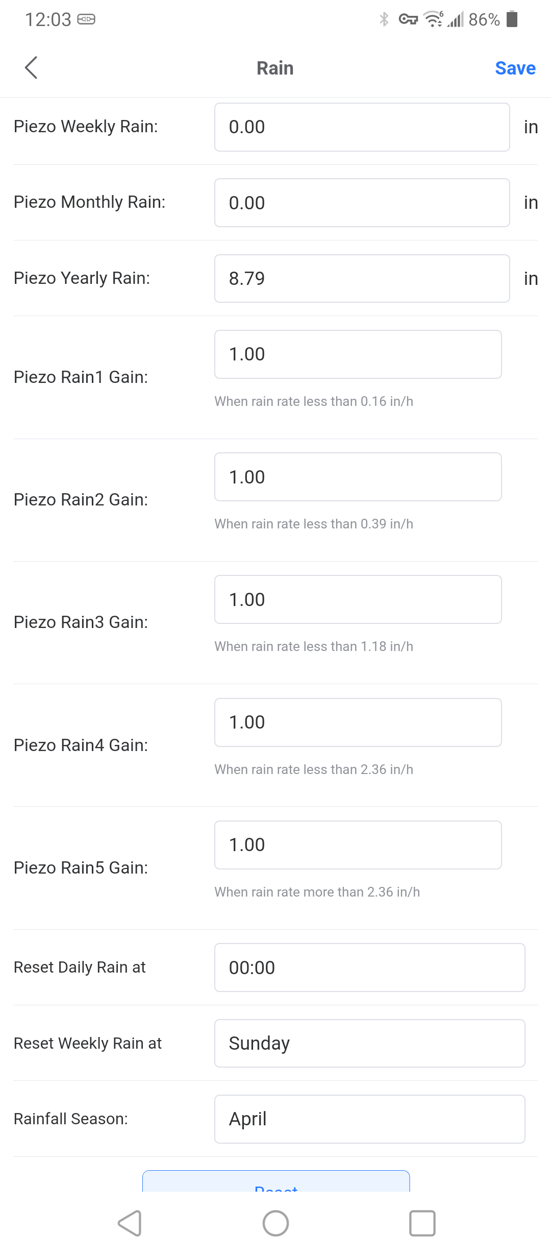

thats what the settings in the ws view app are for raise the number on each of the amounts that are off.
Is it worth using an old-school rain gauge to work out which is more accurate?
Even that is not 100% accurate
It relies in the opening size to let rain in and if there is any wind that changes things. Wind.could nlow more in or less in. Very complicated.
True, I guess no one is 100% accurate. Will be an interesting test then to see them side-by side.
I'm not going to get too obsessive over it, at least not yet. This is just one real rain event. Even the measurements in the traditional rain gauge aren't entirely correct, as since I bought it we haven't had that much rain. When I installed it I had to adjust the yearly rate based on a USGS stream gauge about 3 miles north of my house. At the time I installed it (in I believe May or June), we had only had 11.59 inches. I just thought the difference was interesting, and not at all what I was expecting to see. I may just get a traditional sensor array, set it up on my old GW1100 gateway to see what happens (not including that into Hubitat or anything, just idle curiosity,
