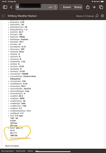

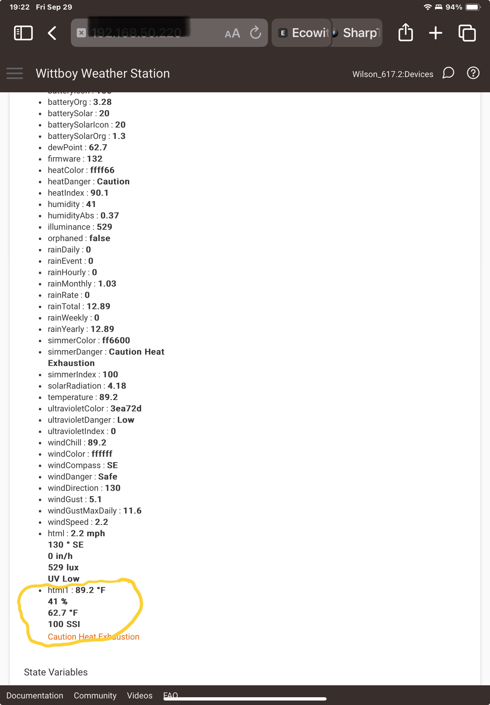

Deleted original question, figured it out. New question, why does this have two temps? Using template 3 and 6
Sorry @lcw731 , was meaning to get back to you earlier. Yes, the templates recommended for PWS are the one's that would best suit the Wittboy, but any that include similar attributes could also be used.
The first temperature is the... well, temperature :slight_smile: The second temperature is the Dew Point.

My next question then is, are these templates supposed to have the Icons included with them? or do they need to be added? using them in sharptools, I get the text, but I'm not getting any icons. I suspect that is why the two temps looked odd to me, like maybe ab icon would have tipped me off to what the second temp reading was.
Yes and no... The icons require some additional CSS, achieved by importing the CSS file from my GitHub repository (actually my GitHub.io repository. If you look at the HTML Templates section of the EcoWitt Readme:
