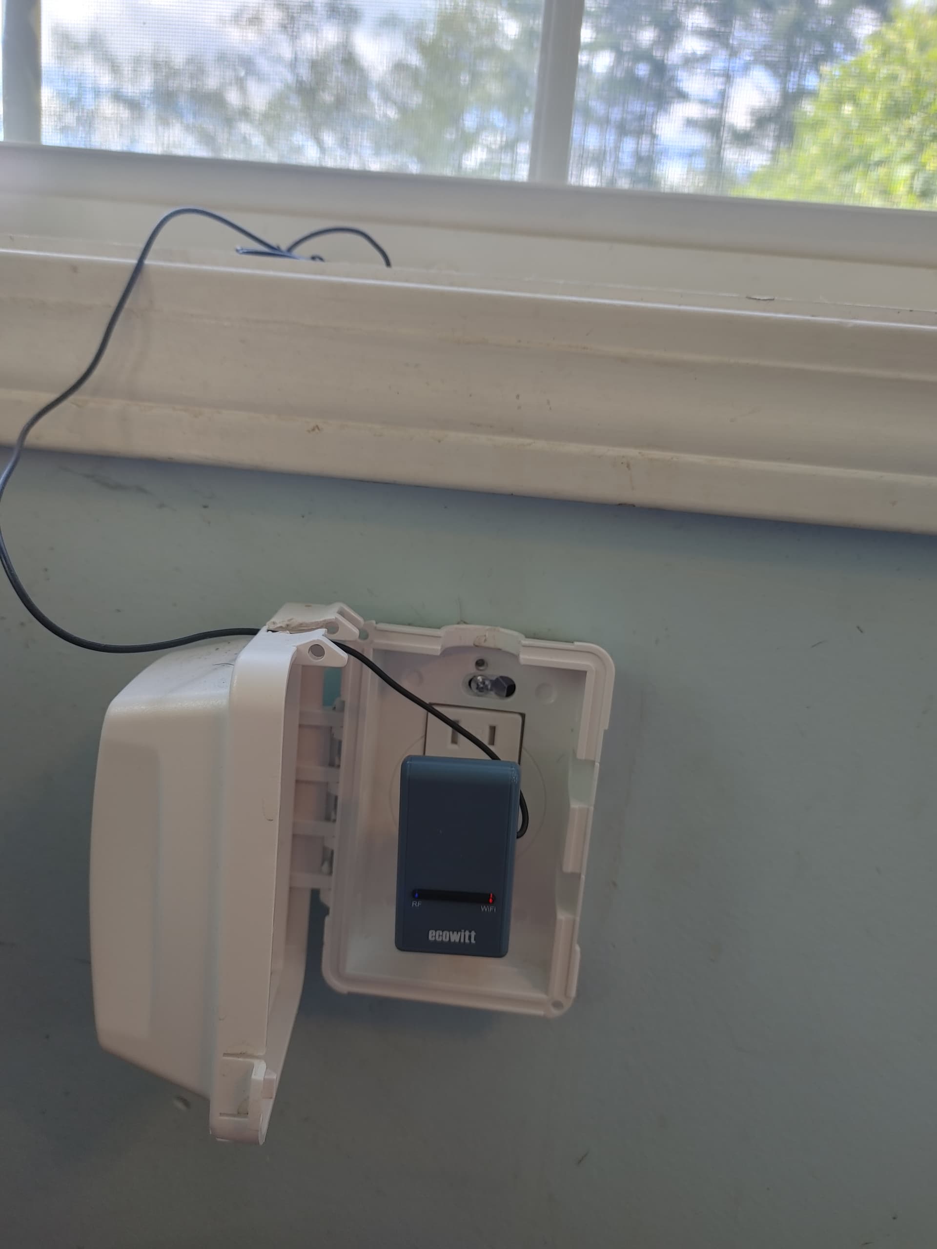

Nope just tested two more . Not turning usb off. And cant find any firmware updates.
I have only one. And it has worked this way since I got it 4-5 years ago,
weird is yours the same part number.. i didnt pair the other two to test just plugged in and plugged in phone to both usb ports and manually with button tried to turn on and off.
Only difference is I bought mine from monoprice.
on phone with their support.. i have like 6 of these between two houses.. i assumed documentation was incorrect but sounds like mine all were fubard or old firmware.
you must be mistaken go retest i also have 7 i bought direct from monprice and found the ordres.. talked to there tech support and they confirmed the usb ports do NOT turn off.
i still like them as they are zwave plus and a strong radio and very good repeater.. many device repeat through them.
Bit the bullet and went old school and put a zwave plus switch in.. i even turned off the circuit breaker this time. Lol
first time i ever was happy about a power outage.. One of the two remote locations is now back online...
