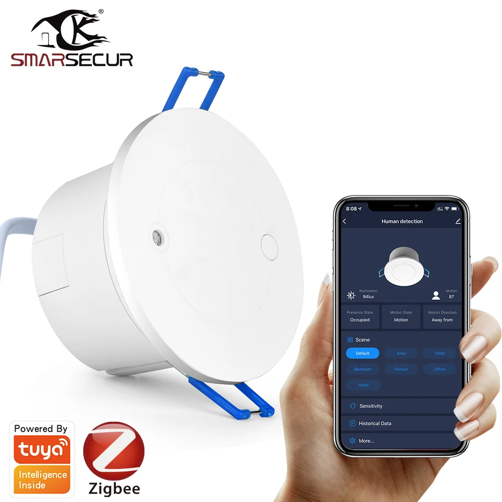

Tuya continues to bring out some very interesting products....
Tuya WiFi motion PIR 110V -240V light luminosity sensor radar human presence detector
Very interesting indeed! Seems it is actually a Zigbee device?
Not cheep, but could be interesting if there was a driver available for it…
Yeah agreed. So many cheap and innovative Chinese products coming out but integration is a real gap right now. I like the idea of having ceiling mounted, mains powered motion sensors and then would willingly throw away all the nasty ugly battery powered devices perched on shelves and stuck on walls.
I would buy this if it were not for the price
This seems similar but slightly less expensive:
Yeah, I spotted that one too but it's so ugly. Seems more like a classic PIR sensor but does also state it can spot static bodies. Weird looking device tho.
Bear in mind that microwave people sensors are just different to infrared. They both have advantages and disadvantages and these might be less useful than you'd hope. I guess that's why intruder sensors use dual mode sensors.
But detecting presence that last once people don't move e.g. asleep on sofa is still not easy at all, cf say fallen too, and not a dog.
That Amazon link says that one does sleep detection though. It is ugly - a bit like a miniaturized CTI scanner

Yesterday I received my "ZigBee呼吸存在传感器 " ( Google translated it as 'ZigBee Breath Presence Sensor'
) -the same model as shown on Sebastian's picture above, but I am highly disappointed with its behavior at the moment.
When a presence is detected, this radar bombards the Zigbee coordinator (the HE hub) every single second with packets containing the distance between the sensor and the detected object. Two such sensors and any Zigbee network will be on its knees ...
I am afraid that there is no way to stop or configure the frequency of these distance measurements updates (I observed the same effect when paired to Tuya Zigbee gateway and configured from SmartLife mobile app), which makes these toys practically unusable outside of an isolated Lab environment. Let's hope I am wrong and there is a way to configure the distance reporting frequency.
