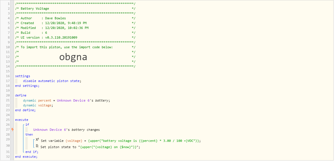

I wrote a piston that converts CR123A battery percentage to voltage. Obviously, you can't use it with the GoControl sensors but it works great for most battery powered devices that use CR123A batteries. It's really convenient to open webCoRE and see the battery voltage right there in the piston state.
I have no idea about webCore or Pistons to be honest. I have not gotten a request to "reverse" the method from % to voltage on any of my drivers but it is a good thought for anyone that needs it in the future.
It could work with basically any battery. Just might want to put a "rated voltage" variable or such that people could set. That is similar to how I convert voltage to % for the couple times I have done it, well, not given them the option, but built in the that target voltage as applicable for the sensor at hand.
