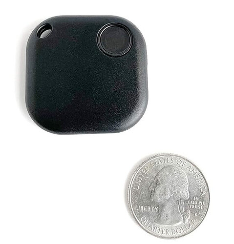

There are BT tags that can be used with the AB BLE Gateway :

The AB BLE gateway reports the approximately distance to each BLE tag (if carried all the time by each person). But I don’t have a practical experience how reliable the distance reporting is (it is based on the tag BT signal strength).
I started with BLE Beacons. They worked wery well but unfortunately they have zero security. Since my goal was not only presence detection but also automatic door unlock and open I replace them with Selly BLE Buttons. This have very high security but unfortunately require to push a button. This happens to be not a big deal because anyway I have to hold an rfid tag for entering into the building and using elevators.

DIY ESPesense project does exactly this. But each person needs to hold/wear BLE Beacon device. Some of them are very small.
